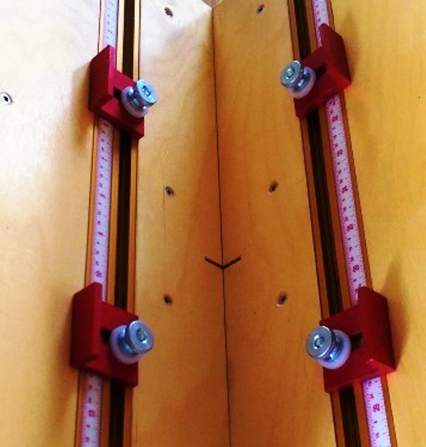

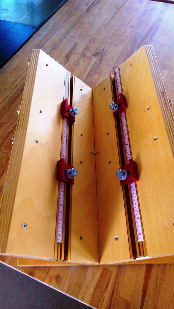

I have not used them together. However, I have the Incra T track on my spline jig. It takes 1/4-20 bolts the same as the Woodpecker track and their flip stop. It looks like the width of the short side of the Incra track is the same as the Woodpecker track which should be the only issue. Obviously when the Woodpecker stop is flipped into position it must clear the track so it seems that there should be no problem.
I don't know where my stops came from. I assume from Incra where I bought the track but they are not on their web site now. They are not flip stop so it doesen't matter for this discussion.

Wow Plastic? :eek: That doesn't sound like Woodpeckers. The ones in my picture are aluminum.
I don't remember but I think they came from Incra when I ordered the track. I am like you, I would not have ordered the track from one vendor and the stops from another unless I knew it would work.
