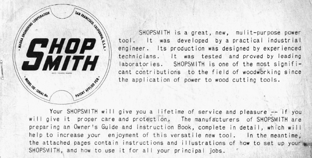

So they are all over the place. Seems to me to be too much deviation for a spacer.
However we have to look at Magna for clues. I have an original Magna Engineering copy of the preliminary manual shipped with the first 10E's.
Page 6 talks about a spacer "bolt" for table saw mode. That to me suggests that the rubber bumper is for that same purpose. I assume the Magna made MK 5's had the bumper and it was not introduced later.
It still begs the question why the width dimension is all over the place if it is supposed to be a spacer.
