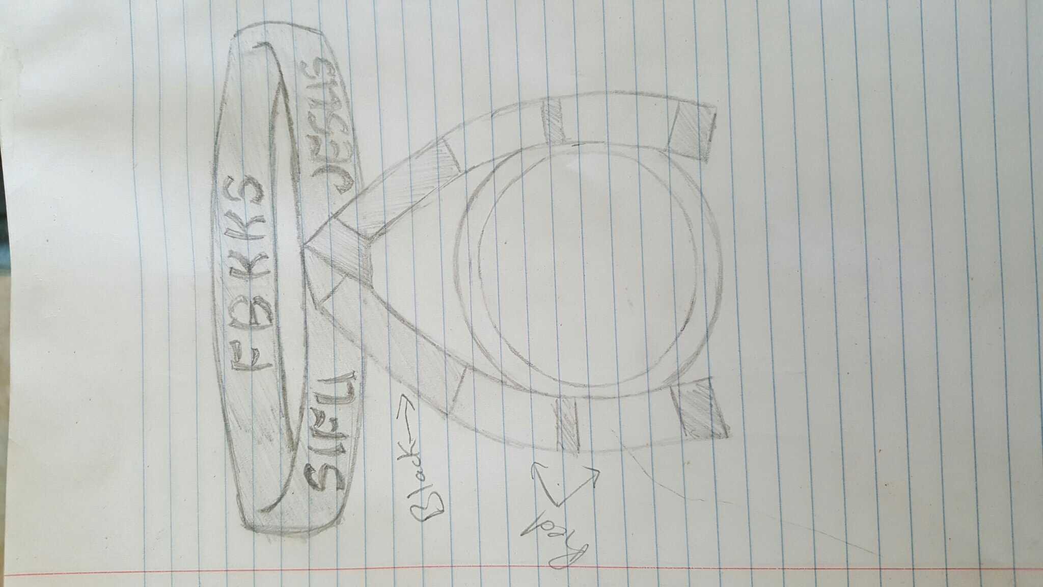

This is a rough sketch of the plaque design I'm wanting to do. I'll be getting my kenpo black belt in a month and want to give 2 of my Sifus these plaques. The other 10 or so I'm planning on giving them some simple pens. Capt Ed's (?) 2 cent pen I think.
This is what will be inside the circle.
The idea is for the belt to be real dark. The stripes should be red. And the Yin-Yang will be a mix of dark and light browns. I have a couple different woods on hand that I can use. I think they'll work. Thoughts?
If I remember what the guys said, I think these are walnut, mahogany and teak. The walnut will be the belt. The mahogany will be the circilsr design/insert along with the stripes on the belt. And the teak will be the circle outline.
I guess to get the coloring I want I'll be using stains. Even though all of this is new to me, the stains are the party I'm least sure about, so ok really be looking for some advice.
The main belt loop and circle will be one layer. On top of that will be a second layer for the belt knot and belt ends. This will give the plaque some 3rd dimension. I guess glue will be the best method of attaching the two?
On the belt loop, where it reads FBKKS SIFU JESUS, I'm wanting to do some form of engraving and/or wood burning. My only concern here is the use of an already dark wood/stain. I'll need to find a way to make sure it pops/shows real well. I'll work on some test pieces first, as with everything else. But again, suggestions are very much welcome.
I think that's it for now. Thanks for reading!
