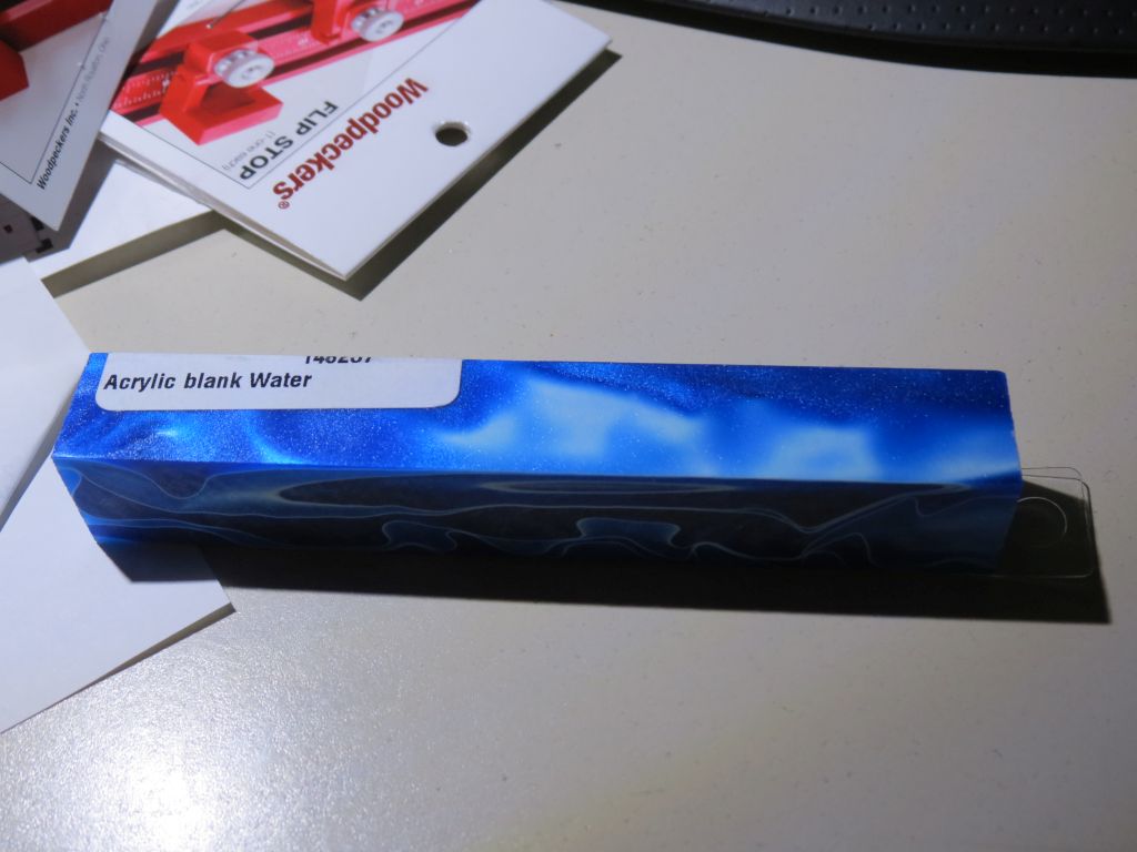

I hadn't thought about the tube showing through. Never have that issue with wood.
This is the perspective blank and I don't think it will be very transparent but before I add glue to the mix I check it in the sunlight.
