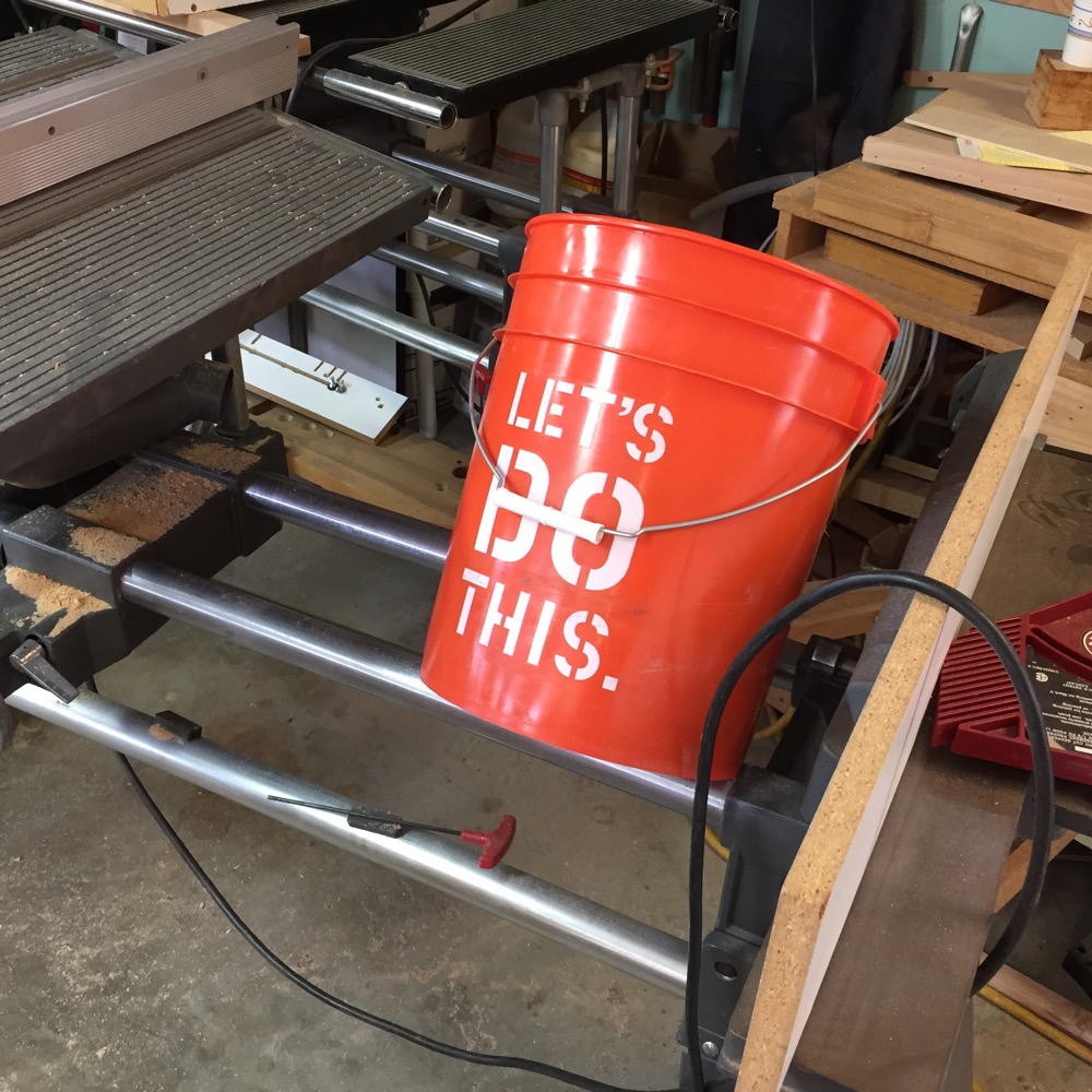

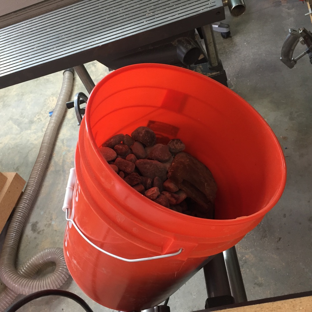

Just about anything will work to weight the MK V down. I have used dive weights but theses days they always seem to be left on the boat. My new method which seems to work well is a five gallon bucket filled about two thirds full of gravel. It has never fallen off and definitely does the trick.
Paul
Paul
