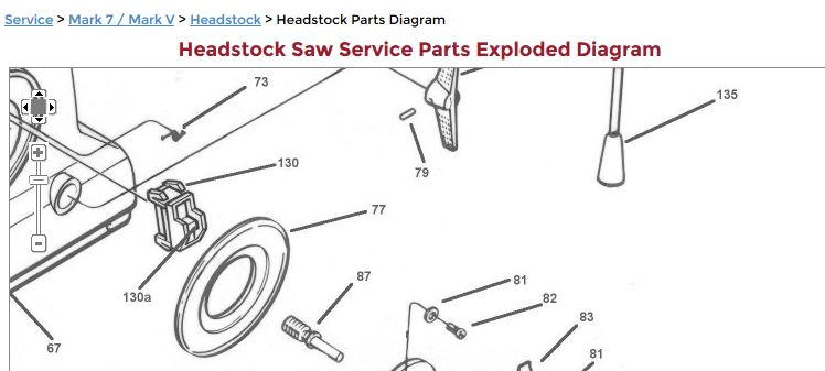

Anyone have the specs on the roll pin that attaches the headstock lock lever to the shaft ?
Paul
Roll pin specs
masonsailor2
- Posts: 1564
- Location: Las Vegas NV
Re: Roll pin specs
I have no specifications and I do not have a pin that I could describe. You probably already know that it is item #79 in the exploded parts view but when you click on it you are shown the next higher assembly (Headstock Lock Assembly 513014). Based on my past experience, if you call Shopsmith you will be told that they do not sell that item as a piece part.
- Capture Headstock Lock Assembly.JPG (41.51 KiB) Viewed 2630 times
