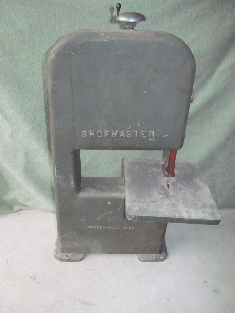

I have never broken a blade on a Shopsmith bandsaw nor on another old bandsaw I used to have. Well, actually I still have it, just not in the shop. It is a very old Shopmaster, about a 10" I think. It looks just like this one but has been painted bright blue.
I did break a few blades on a truly ancient old industrial bandsaw i had many years ago. Picked it up at a selling out auction of a local contractor. It was huge and really heavy. The blade wheels were 24" and the equally ancient 2 HP motor weighed a couple of hundred pounds. The whole thing was 8' tall. It was originally made to be ran by an overhead line shaft. Like many old industrial machines being used by local contractors any kind of cage or guard was long gone if it ever had one.
I built an 8' table on each side and was mostly using it as a small sawmill. The first time a blade broke and came slamming down across the table I built a wooden box guard for it, right after I changed my underwear...
