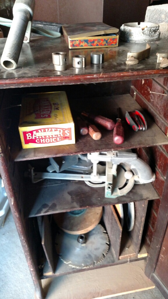

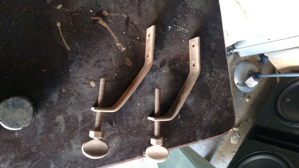

First off let me start with a little background. I live in upstate NY with my wife and 1.5 year old son (which means not alot of shop time). I started woodworking about 5 years ago with plans of the perfect shop with the best machines. In a matter of months I had outfitted my shop with no machines, but hand tools. I am now a "hand tool only" only woodworker. Last Monday is where that changed, and where you all come in. I got home from work and my wife tells me she has a surprise for me. She said she was on her Facebook and an old friend had posted something as free and my wife being the lovely lady she is had no idea what it was, but that it was a tool and said MINE! She showed me a picture and I lost it. A shopsmith. She was told that it just needed a new belt to work. So with her birthday being on Wednesday, she told the lady we would be there Wednesday to pick it up. I did my research on how to get it home and found out it was a very early greenie. When we got there, there was the SS with the jig saw and all the normal stuff, table rip fence and all that. There was also a wood cabinet on casters full of stuff. Saw blades with arbors, a LOT of 12" sanding discs, the set of lathe chisels in the box, and alot more. I'll start to wrap it up cause I know I'll be posting alot more. First I'm wondering if someone knows the size of screw that hold the belt housing on. They were taken off and lost and I need to replace them. Also In the metal cigar box that had all the lathe centers and router bit chuck and stuff like that there was a few pieces I could not identify. There was also 2 brackets in the cabinet I'm not sure about. So I'll post pics and hope someone can help. Thanks for reading!

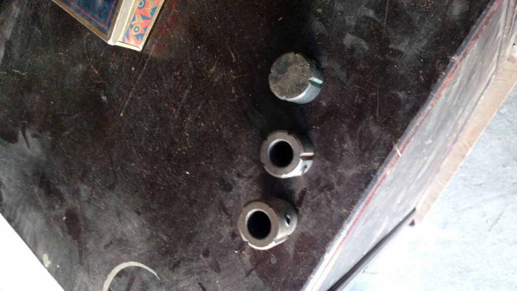

- Unknown Parts
- rps20160621_122948.jpg (70.85 KiB) Viewed 2138 times

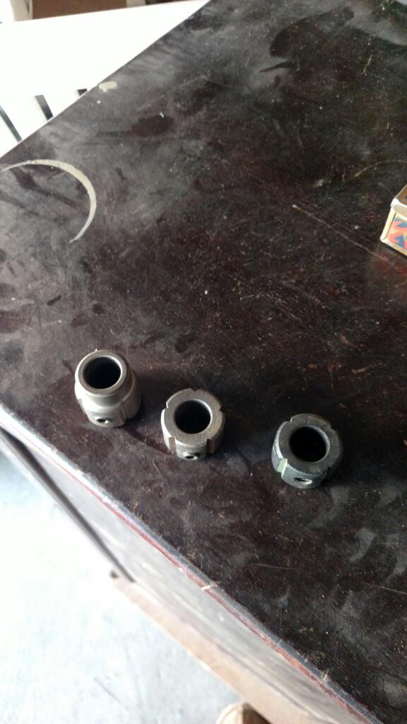

- Parts flipped upside down
- rps20160621_123451.jpg (201.22 KiB) Viewed 2138 times

- Cabinet
- rps20160621_123847.jpg (201.84 KiB) Viewed 2138 times

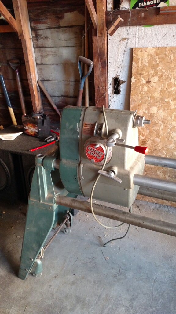

- Headstock
- rps20160621_123952.jpg (228.04 KiB) Viewed 2138 times

First pic are hubs for the coupling connector that connects the head stock to accessory power tools.
Re: SS Parts
Ahh that makes sense. The coupler is in the other cigar box. Thanks!

For future reference you have an "A" headstock(there are also "B" and "C" versions.
Also you likely have a "Gilmer" belt drive(cogged belt).
The belt cover screws are IIRC 8-32, but quite likely the threads in the aluminum headstock are stripped.
The two belts( a gilmer and a v-belt(of unusual size(s)) are available pretty much only from the MS(mother ship) aka shopsmith.
Those brackets are of unknown origin(at least by me).
