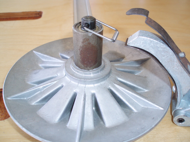

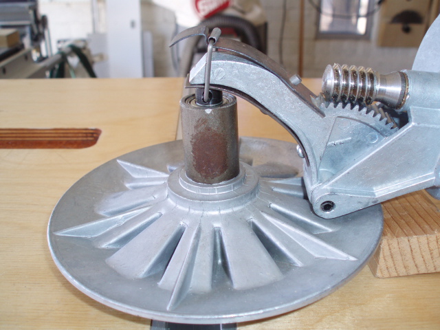

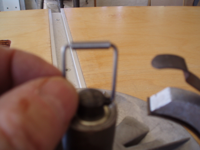

The loop is part of the control sheave.jbuis wrote:Regarding the sequence of installation, is the loop attached to the control sheave first? Do you then have to insert the speed control through the loop while installing the speed control or can the loop swing over the end of the speed control after the speed control has already been installed?
Jim
After the entire machine is assembled the loop can be coaxed to swing over the speed control assembly. The spring (a single metal leaf) on the speed control must be pushed toward the control sheave and while held down with one finger, the loop can be coaxed to flip over the spring.
The second snap shot (out of focus) was made to show you how a small rollpin fits through the nub on the bearing - and the loop fits into the rollpin.
I didn't try to remove the loop!

Charles,charlese wrote:The loop is part of the control sheave.
Thank you very much for the photos!!! Of course, they do bring up more questions. My SS is a 1956, so it may be different in some respects. My control sheave, at least in its current condition, does not have a roll pin in it, only a hole. The original speed control was bent badly, probably by the quadrant loop coming loose and the control sheave slamming into the speed control. I bought a new speed control from SS.
My loop has the coiled spring piece on a different part of the loop. It is on the side compared to yours being on the end, that is to say the spring piece is at 90 degrees compared to yours.
I guess I'll check the diameter of the hole in my control sheave to see if it is large enough to accommodate a roll pin. I think it is too small for that.
Does anyone know if the loop arrangement on the old greenies is one of the things that has been significantly changed on the newer models?
Thanks,
Jim

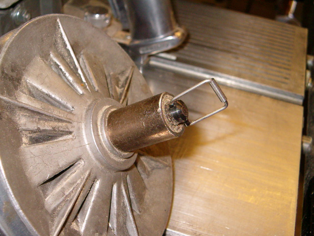

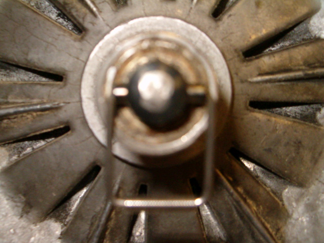

I see Charlese has been "Johny on the Spot" with his photos. I have a couple others to offer. Same subject, slightly different view.
The spring belongs where you see it in the not so good 4th photo. I don't know if you can move it around the corner or not. I tried to move mine but wasn't willing to apply enough force to make it go around the corner.
The spring doesn't function like a spring at all, it functionsis more like a bearing

Okay, I was able to slide the spring/bearing around the corner so that it is now positioned the same as the two of you have shown me in your pictures.
Thank you both very much for going to the trouble of posting the pictures.
I still need to measure the hole in the control sheave to see what size the roll pin would need to be. I think the previous owner must have put it together without the roll pin which led to the damage I have had to deal with.
