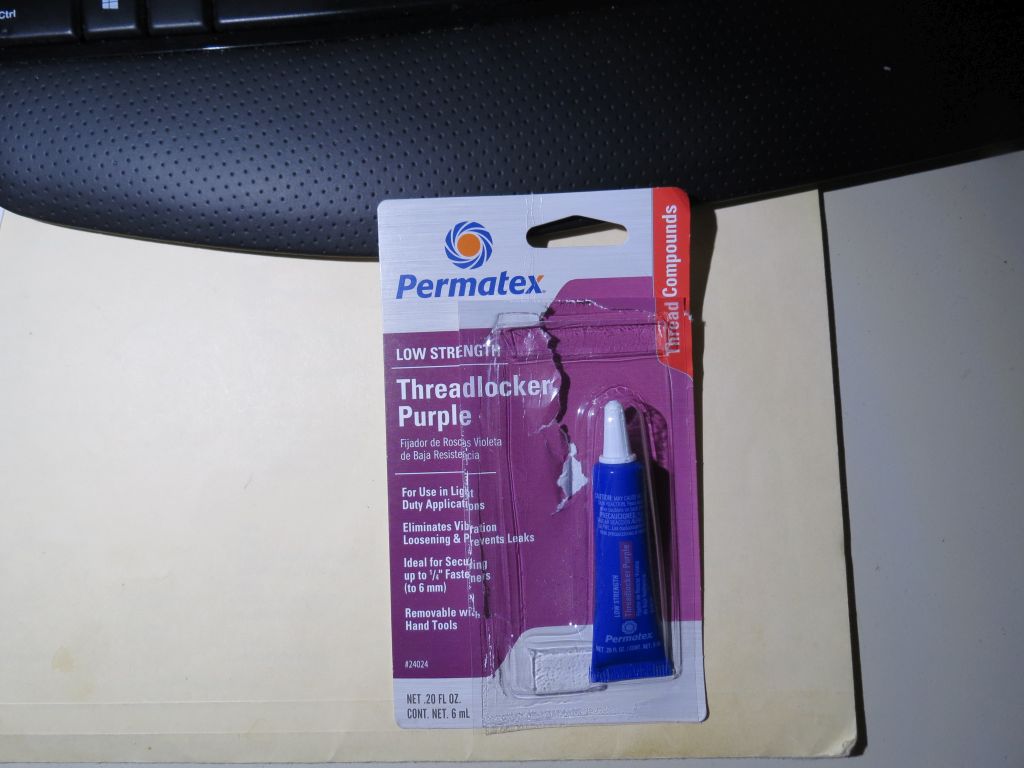

Re: Simple Set Screw Fix
Perhaps a bit off topic but I wanted to point out this product which is good for smaller set-screws, 1/4" and under. I just learned about it back in April of this year and so far I like it. Note that it is Purple......... I think the small tube ran me $5 or maybe more like $6 but when working on smaller set-screws it seems to be a better choice.
Note the brand if you go looking for this.
I may give this a try on some 5/16" stuff but so far I've justed used as recommened on smaller sizes. It should work for that as well just a weaker bond.

Tube sure looks blue to me ;)
Packaging looks purple though
