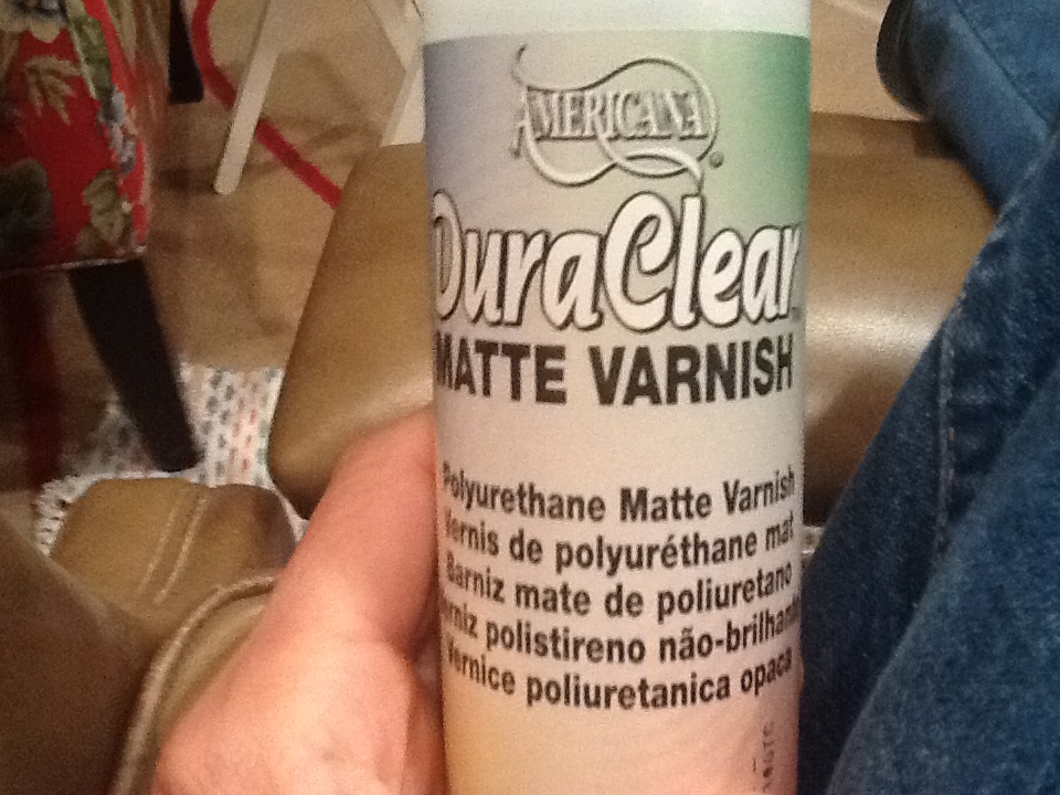

wrmnfzy
Posts: 758
Location: Destrehan, LA
Re: Craft finishing
Post by wrmnfzy »
Water based. I've attached a picture of bottle.
ERLover
Posts: 3914
Re: Craft finishing
Post by ERLover »
I dont have an answer, other then try a different brand of water base poly and try it on a sample piece. I have used MinWax and did not have much yellowing, but it was not over white.
