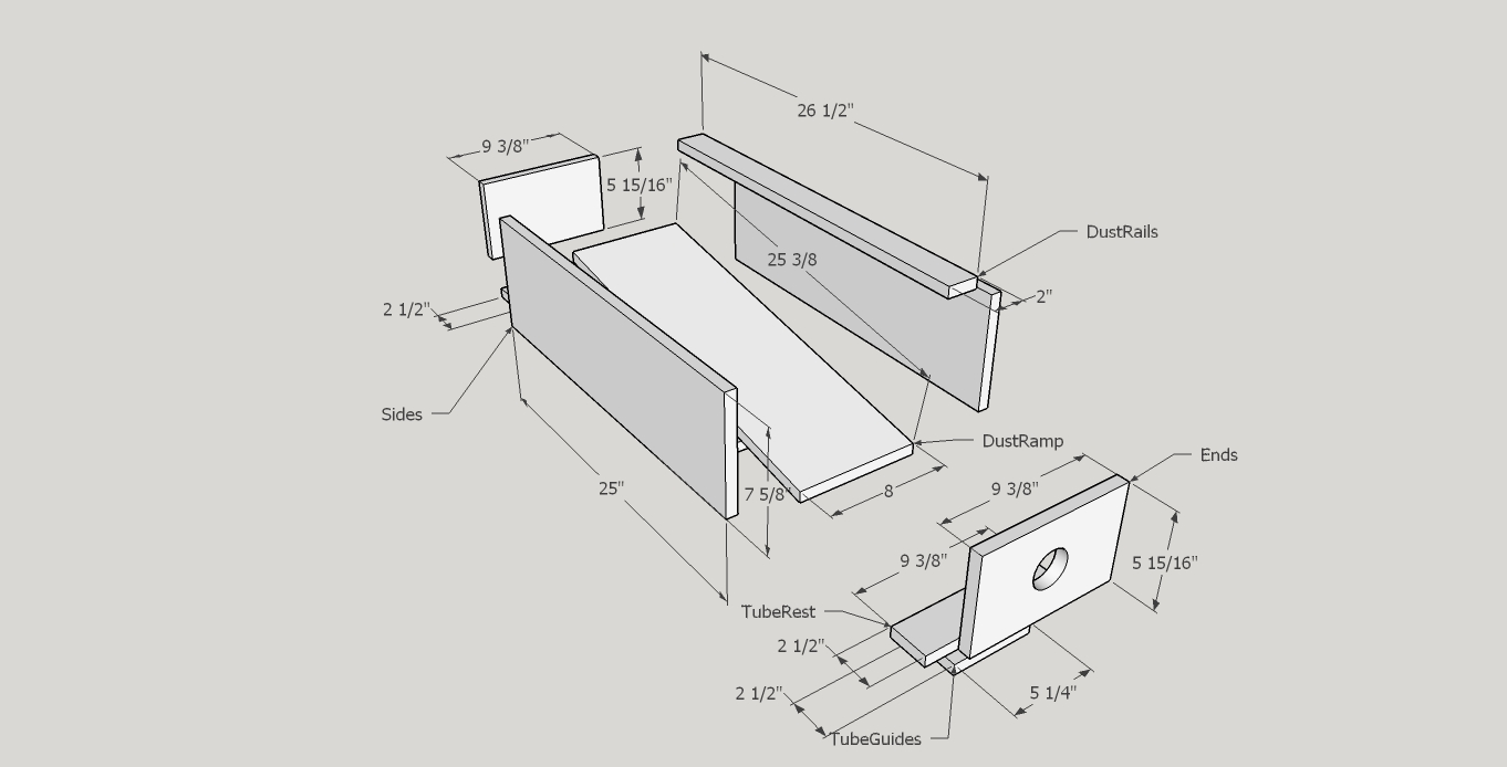

Below is an exploded drawing with the necessary dimensions for use on the Shopsmith.
Key dimensions are the height of the sides (7 5/8”), height of the ends (5 15/16”) and the length of the dust ramp (25 3/8”). The three tube rests lie on top of the way tubes and the tube guides ride between the way tube and each are made from the same ¾” Baltic Birch. The width of the tube guides is critical, you want them tight enough so there is no play side to side but loose enough so they slide up and down the way tubes. I started at 5 3/8” and through trial and error ended at 5 ¼”. I didn’t cut the tube rests to final length until I mounted the box on top with the drum perfectly aligned to the Shopsmith spindle. I then attached the tube rests to the sides and cut them to length. The tube guides have a 3/8" hole with an epoxied nut to allow mounting of the Carriage Clamps. The cut out for the left side of the top MDF base will have to be extended to allow the flexible coupler to turn freely. The base is also connected to the box using the 24” piano hinge. The sanding drum is mounted on the sides using the bearing mounts that come with the kit. A picture showing the inside of the box is shown below. The drum has two different grits of sandpaper mounted.

I just ordered the 24" drum from Stockroom Supply and was about to start making my sander, when the vendor sent me a link to your post. I was planning on mounting mine to a spare main table and direct-linking the sander shaft to the SS drive shaft with a 5/8" coupler. Your solution of mounting the sander box onto the way tubes interests me, but I'm having trouble visualizing how you mount the box. Do you have a photo that shows the underside of your box? Very impressive workmanship! Thanks.
sehast
Posts: 497
Location: Milpitas, CA
Re: Building a Drum Sander for the Shopsmith
Post by sehast »
jprice wrote:sehast
Look at the Tube Rest and Tube guide on the exploded drawing. A Shopsmith Carriage Clamp Assembly 516146 is needed to screw into the bottom of the guide. That clamp is shown on the Shopsmith Planer diagram here
http://www.shopsmith.com/service/mv_pla ... iagram.htm
items 81 and 82. But it is also sold as a complete assembly 516146. A 3/8" hole is drilled in the middle of the tube guide. I then took a 3/8" nut and mounted it sandwiched and glued in between the Tube Rest and the Tube Guide. You will need at least 2 clamps one on each end. The middle tube rest and guide does not really need a clamp. I used one because I happen to have an extra clamp.
I think you will find that mounting on a table will give you very little room for the 4" drum to turn inside the box with dust collection. It probably can be done but it is going to be tight.
