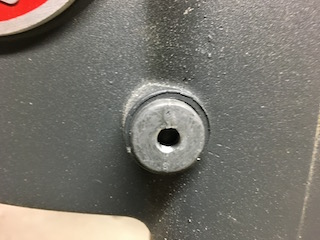

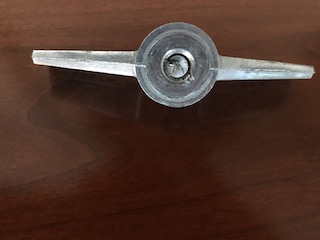

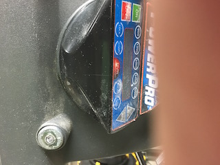

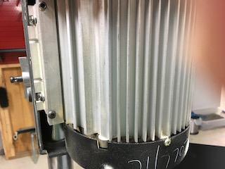

Thank you to you folks who replied. It is the headstock lock that is broken. The Shopsmith Power Pro is direct from the company. Here are pictures that I hope will help.

If I understand correctly, this is a PowerPro headstock purchased as such from Shopsmith. If that is the case and you have not already discussed this issue with Shopsmith, I recommend that you do so immediately. I would do no more work on the unit without speaking with them.
Being a new unit it is most likely not a rust problem which headstock locks often are.

You may find some help with the DIY upgrade video (3 minutes) that illustrates what is involved in a DIY upgrade.
http://www.shopsmith.com/shopsmithpowerpro/pp_diy.htm
With the lock broken, you have to leave it on the way tubes, but you can go vertical if possible and reinstall the table from the opposite side to use it as a work surface to work from as you seem to have done in the photo.
Use blocks to support it from falling if you cant move carriage itself.
Once you have the DVR motor and Power Supply out, you can cut the rod in half to remove it, replacing only it, if the wedges are not damaged in some way.
