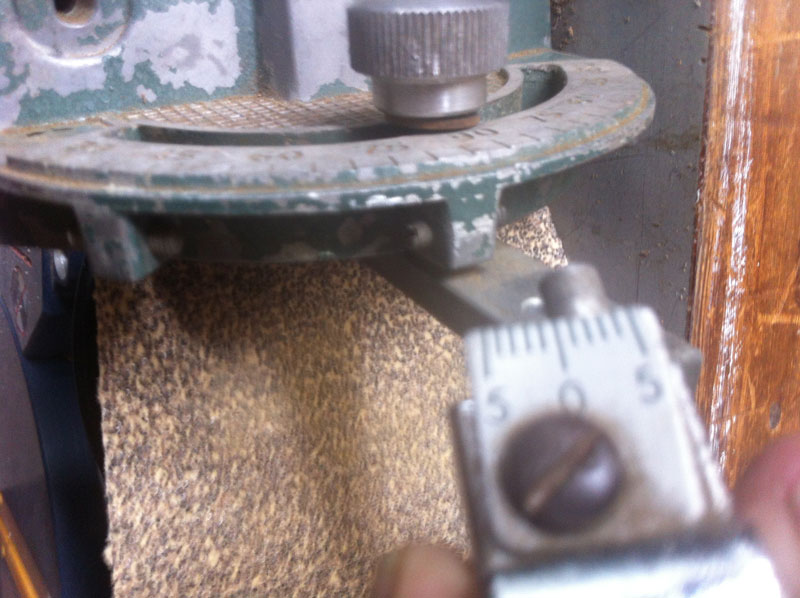

As I've blathered about in other posts the Greenie I inherited came with about 100 doodads all in a foot locker. So I've been putting this thing back together with lots of head scratching.
Is this gizmo part of something? If so, what?
TIA.
--JC
TIA.
--JC
- IMG_1224 (Small).JPG (42.45 KiB) Viewed 1961 times
Greenie #317956. Jointer Model 620 #40077
Re: What Is This?
That should be mounted on the end of the miter gauge bar. It provides an index and a stop for the protractor head.

Ah.... one problem. The dowel (pin) that sticks out the end? There's no 'receiver' on the miter gauge I've got. I see how it screws onto the underside of the bar, but where's the 'hole' the thing fit into?JPG wrote:That should be mounted on the end of the miter gauge bar. It provides an index and a stop for the protractor head.

Your 'greenie' should NOT have a Mark 2 miter gauge.suntower wrote:Ah.... one problem. The dowel (pin) that sticks out the end? There's no 'receiver' on the miter gauge I've got. I see how it screws onto the underside of the bar, but where's the 'hole' the thing fit into?JPG wrote:That should be mounted on the end of the miter gauge bar. It provides an index and a stop for the protractor head.
My miter gauge looks like this:
http://www.ebay.com/itm/like/2625194768 ... noapp=true
Ideas?
TIA,
---JC
There is no hole in the greenie miter gauge neither.
The pin projects and a stop screw bumps against it. There are three stop screws. The set screws provide adjustability. The pin is retracted for setting all other angles.
How about a pix of the underside of the one you have.

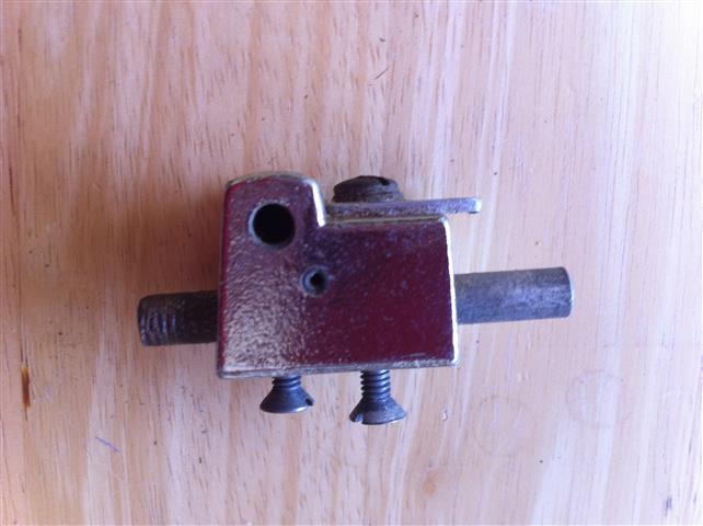

Re: What Is This?
Damn. I sure wish I didn't have to hook up a cable and perform like 12 steps every time I wanna upload a piccie. (Old guy rant).
OK... hopefully -this- explains my confusion. I'm sure it's something obvious.
Is the pin/dowel somehow removable?
Appreciate the help!
---JC
---JC
- IMG_1232_small.jpg (93.54 KiB) Viewed 1870 times

I feel your pic pain, remove the thing from the camera, hook up to the computer, then store it,ect then go here and find where stored, I put it on the Desk Top, then post it here. BLA BLA BLA.suntower wrote:Damn. I sure wish I didn't have to hook up a cable and perform like 12 steps every time I wanna upload a piccie. (Old guy rant).

The thing in your right hand does as JPG said on a greenie Miter gauge, I dont know what Miter gauge you have there, But if JPG ses it a a Mark? it is.suntower wrote:Damn. I sure wish I didn't have to hook up a cable and perform like 12 steps every time I wanna upload a piccie. (Old guy rant).

The pin doesn't go into anything....?

So... is that pin supposed to retract (move back and forth?) My is stuck in that position. Is there a screw that locks it in place? How do I loosen it?
