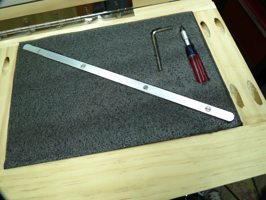

The old it didn't happen without a picture says I have to show you this:
This is coming along pretty well. I do want to add some finger areas but will do that when I can work outside and use the copper pipe and torch to do it. I wonder if this will smell???
