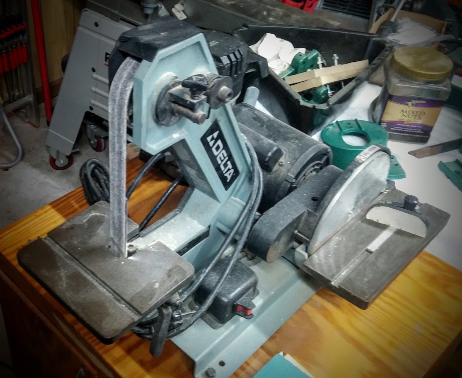

I've owned my Delta Strip Sander for twenty years or more. It's never given me a bit of trouble. I have sanded lots of toy wheels with it. Its heavy the body and the tables are cast iron. Where ever you put it it stays there. Rikon and Jet sell very similar models. The rikon looks like it was made in the same factory.
Delta Strip Sander
Delta Strip Sander
Delta Strip Sander.jpg (132.04 KiB) Viewed 10949 times
