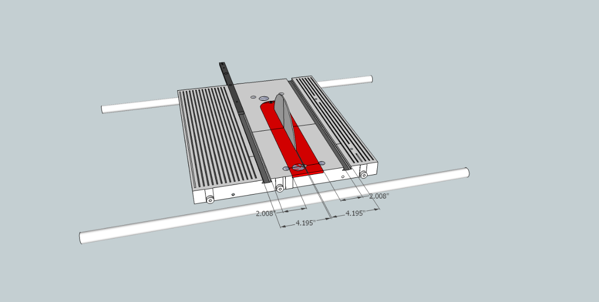

I also align the table so that the axis of rotation (of the main spindle) is at a specific location on the table. I am likely the only one to do this but it does come into play during drill press operations.
- Main Table ONLY.png (140.14 KiB) Viewed 4415 times

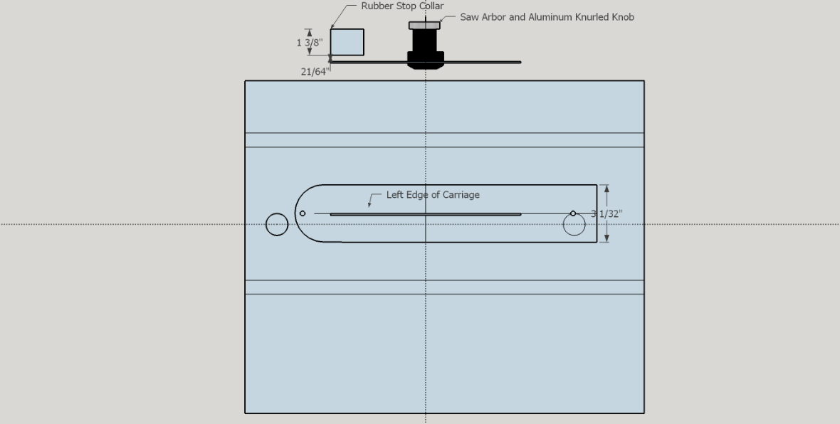

A Graphic from a Different Thread Different Subject but same axis:
The dashed lines are the axis of rotation.
- Spindle and Table Axis of Rotation.png (37.8 KiB) Viewed 4345 times
