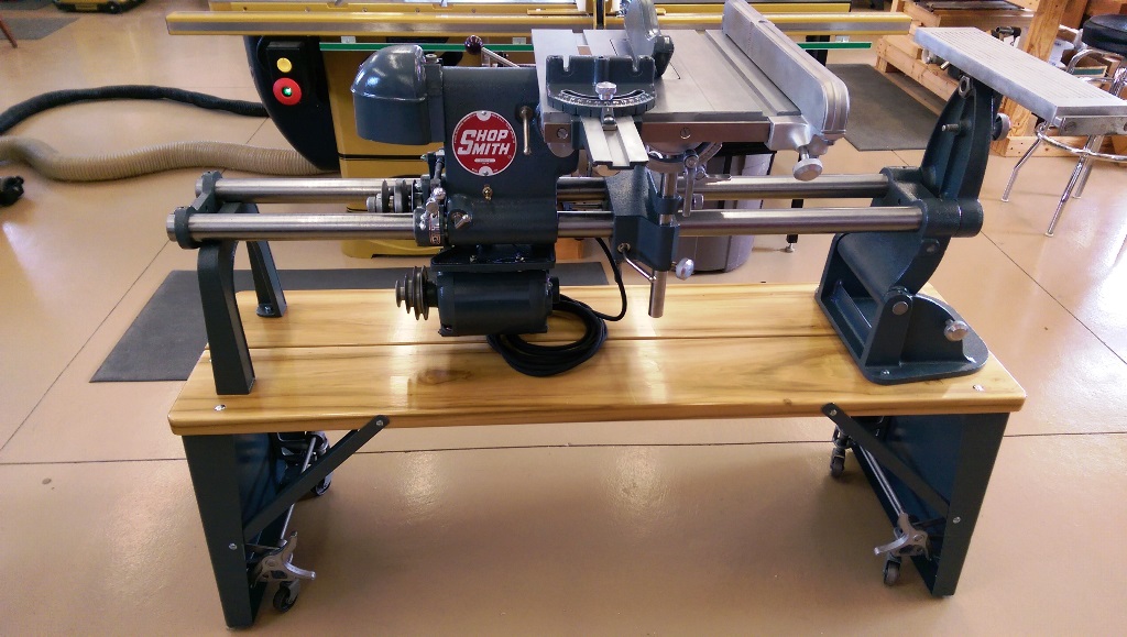

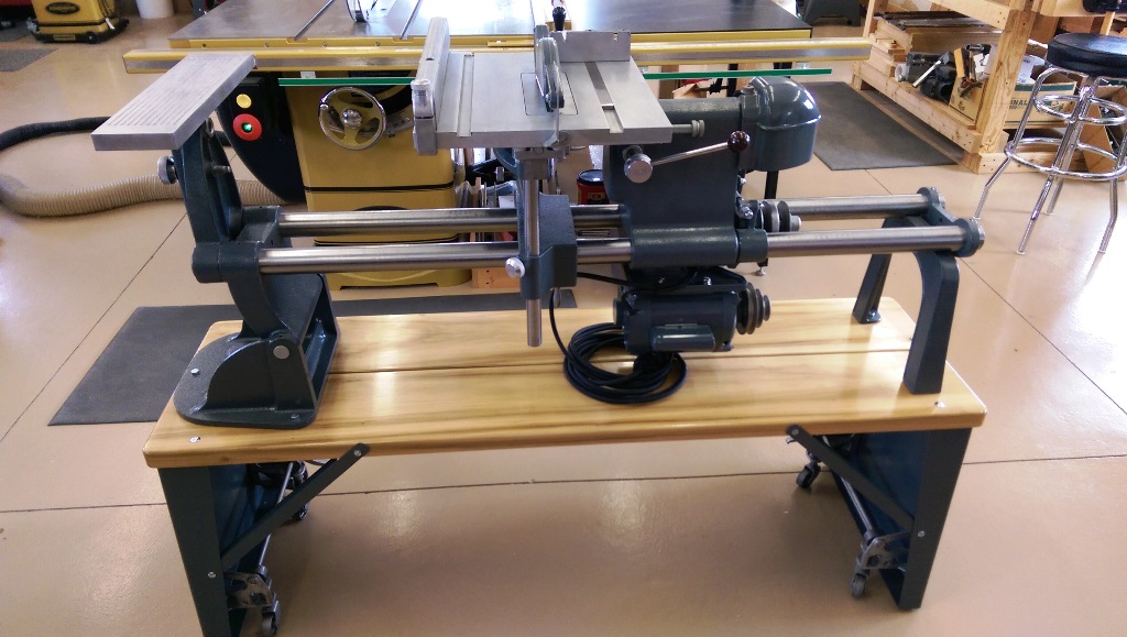

I use 80 grit glass media blasting and then 320 grit on a PC air powered random orbit sander along with Nylox wheels on the small areas. That is on 10ER's. The glass bead blasting won't work the MK V painted tables but the 320 grit ROS will work on the aluminum top surface.
- IMAG0316.jpg (205.19 KiB) Viewed 8703 times
- IMAG0320.jpg (200.95 KiB) Viewed 8702 times

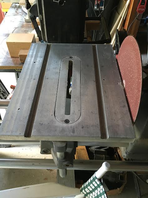

Pics of a bad cast iron SS Band Saw table. I started with with 240 AO wet with MS then, 320, then 400. Oops deleted off of Desk top, no I am not doing a 3 thing process again tonight.
