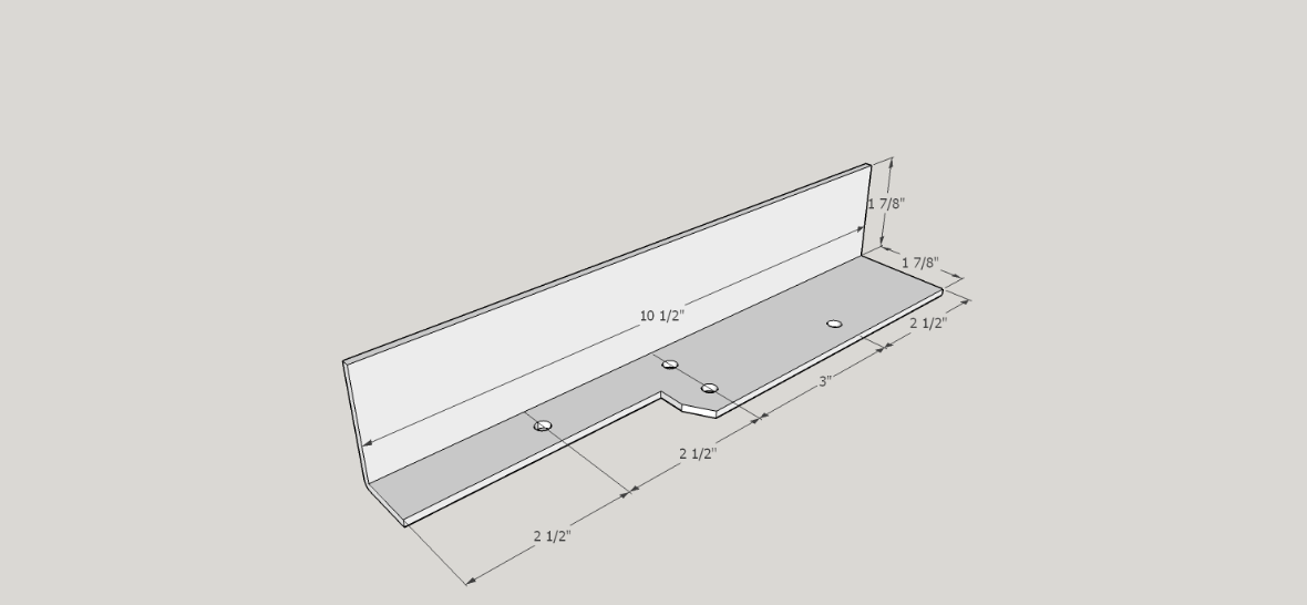

I started to do something very similar when this was discussed on the forum earlier. It just never got done. I clamped some steel bar stock to the underside to see if it had any effect. The kludge job did seem to reduce the noise and vibration significantly.
This is a sketch of what I had had in mind. DO NOT USE THESE DIMENSIONS. They are only concept estimates.
It should go without saying that a mirror image of this would also be required.
Posted with this image in error. This is not my concept. This rendition was my attempt to "copy" Buckeye's photo. Mine was a simple flat plate.

Dusty, you may not like me all the time, I hope some times, but you are The Prince of gadgets,modifications and detaisdusty wrote:I started to do something very similar when this was discussed on the forum earlier. It just never got done. I clamped some steel bar stock to the underside to see if it had any effect. The kludge job did seem to reduce the noise and vibration significantly.
