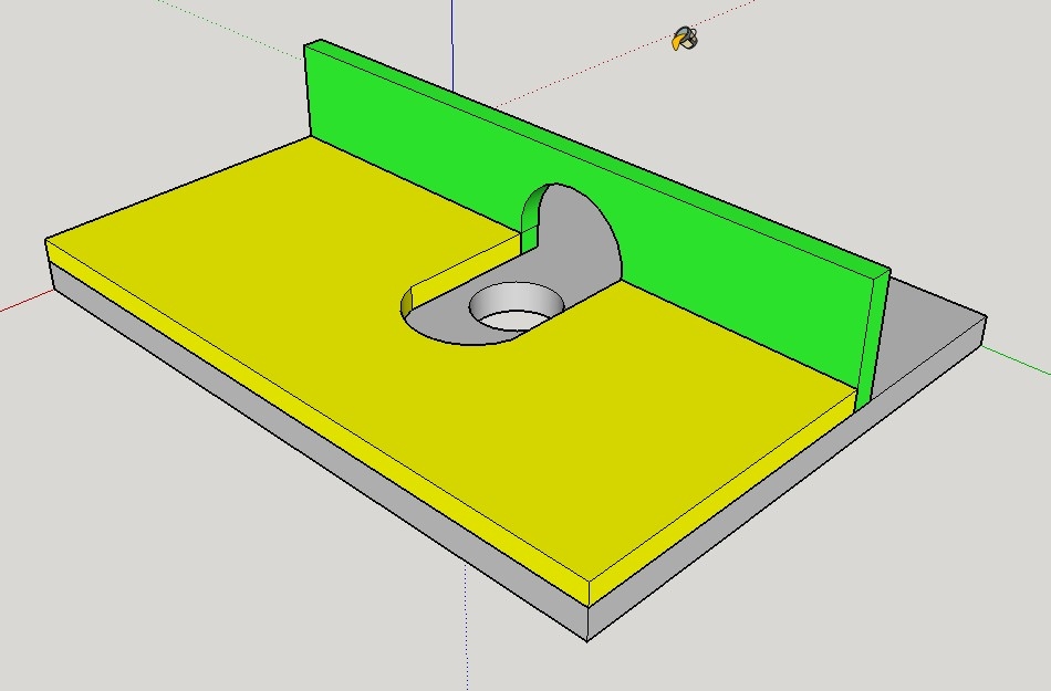

Re: Raised Panel router bit with back cutter
In the end this is going to be up to you and how safe you feel about the operation.
First this need not be an above the table operation. For may years people have done what is called a false top. This in the most simple terms is a top that sits on the table that has a cut out to match the size of the bit you are using plus a little.
Next since this has the under cutter you will have to make a pass then move the fence to make a second, third and 4 cut. You can not change the height of the bit.
You will likely have to make a fence with the false top to accommodate this. I can do a quick and dirty sketch to show you the basics of how this would work if you are truly interested in do the project this way. You will have to provide your own details.
Since you can use the false table and get the bit coming from below this is no different then how it would be done on a router table and I would view it as perhaps as safe as a router table.
Perhaps just for completeness I will make a sketch later tonight or tomorrow so we can all learn a possible new idea to some.
I forgot to ask but did you get the dual tilt with the powerpro? If not then you are stuck with this as an above the table operation.
This is a quick sketch of the idea. You might be able to use the movement of the table in and out to do the depth of cut adjustment.
You would also need to cover the back of the bit where it might be exposed but this is the general idea.

As for a fence, it seems to me that the Mark 7 (520) fence could be adapted very easily, as it has nice T-slots on both sides, and clamps rock-solidly to the table. I'd glue up a beam about the size of a 4x4, and mill it flat and square. Then I'd cut it in half length-wise, and mount the halves to the side of the fence using T-nuts and recessed bolts. Presto, I've got a jumbo-sized router fence, with adjustable sliding faces, that can completely swallow a 3-1/2" bit. If you glue up a hollow beam for the sliding faces, you can even hook up a dust collector. Depth-of-cut adjustments would be made by moving the fence.
You'd still need Ed's "false top" to space the workpiece such that the router bit clears the table. Simply clamping on a piece of MDF should work fine for that.
