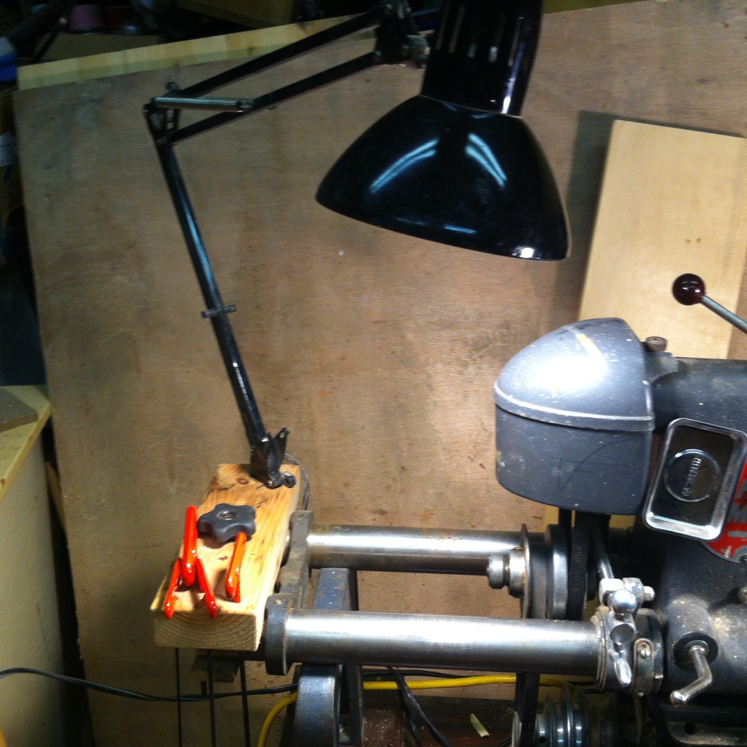

Just checked mine, I have 2 1/4" past the tie bar. I have no recollection as to how I arrived at that number, on the vertical one it is 1 3/4 which makes more sense. The intent was to leave enough space to mount the tailstock/extension table but I haven't had occasion to do so.
On the other hand it has given me a place to mount a lamp/Allen key holder that doesn't interfere with moving the headstock or carriage. :cool:
lamp allenkey holder.JPG (235.46 KiB) Viewed 1821 times
