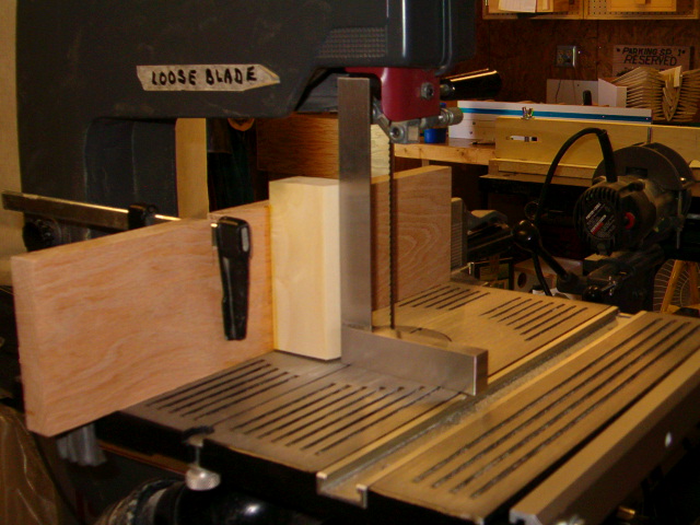

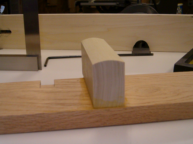

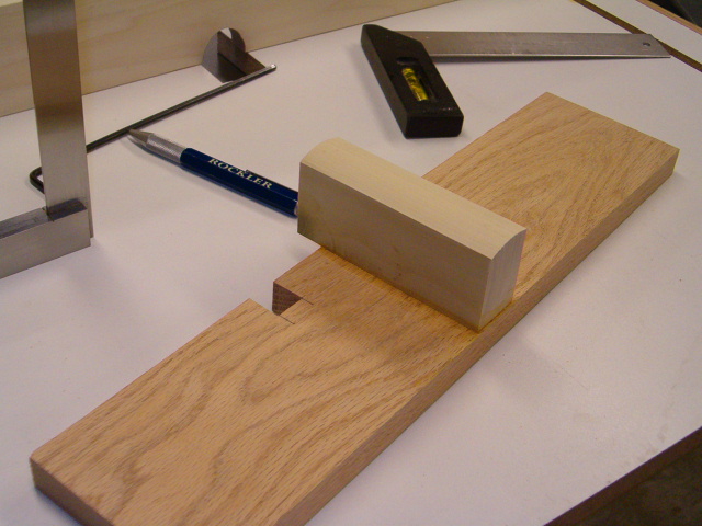

After posting #4 (above) I had about an hour - so went to the shop and made a guide like I had mentioned. Previously, I had used square pieces of wood or plywood - rounded one edge and clamped the piece to the table. This is because I never thought ahead far enough to spend a little time making a jig. But have to say that a single piece of squared wood works better for me than trying to adjust the fence. The most difficult part of making the jig os to sand the bevel so it is vertical to the table. (parallel to the back of the mounting board) Photos of the new jig below. If you wonder what the squared notch is for - it is for the bar of a small clamp (photo #1).
As far as the guide from the SS catalog, Duh!
It probably fits somehow on the Kreg system as Dusty suggested (asked). I had been confused by the catalog's statement that it fits the T slot on the side of the fence. Just didn't read enough of the catalog!
It's the Kreg bandsaw fence that has side slots.
The jig I made is simply a poplar scrap glued to an oak scrap. After the glue set, I drilled and inserted two 1 1/2" #8 FHWS to the back. and waxed the bearing face. It should work as good or better than the single piece of wood.

[ATTACH]1639[/ATTACH]
[ATTACH]1640[/ATTACH]
[ATTACH]1641[/ATTACH]
