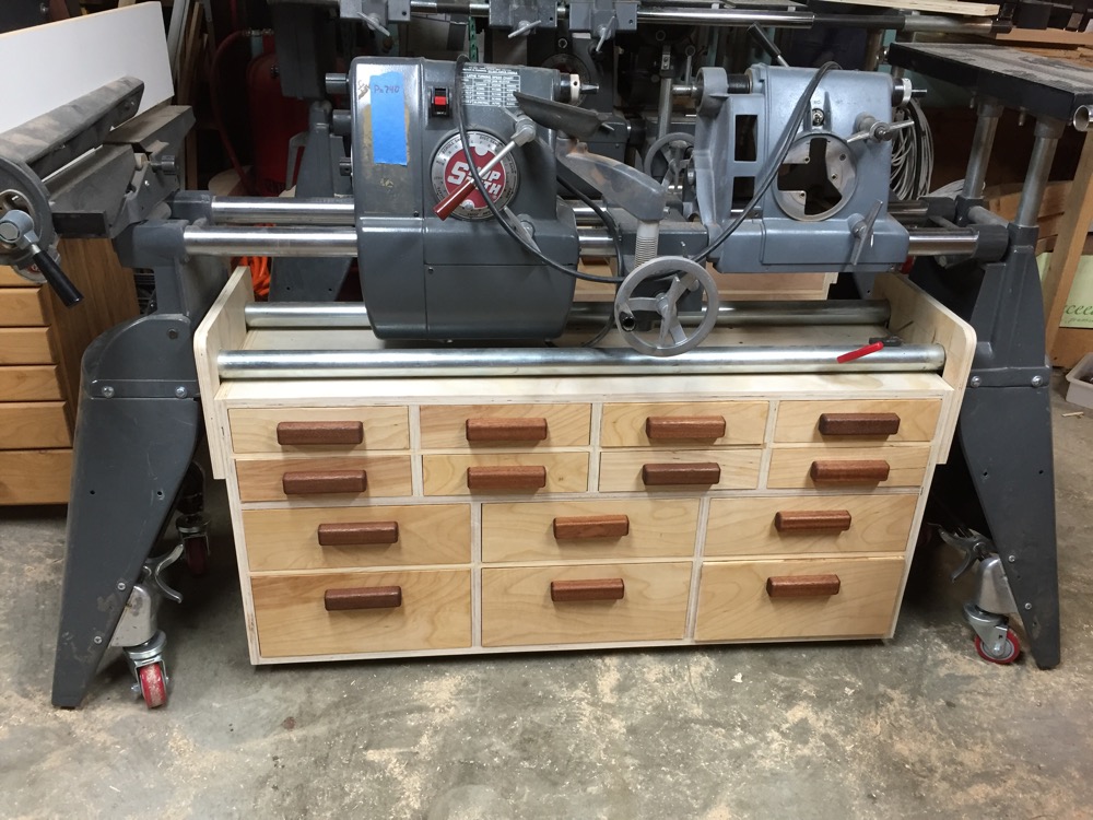

Awhile back I posted the under Shopsmith Cabinets I made, now after some time has passed, I am beginning to think I should hang the cabinet from the Bench Tubes, as I move it around, the cabinets gets in the way, I am thinking it would be better to hang it and when I move my Shopsmith the cabinet moves with it, lets hear some Pro and Con.

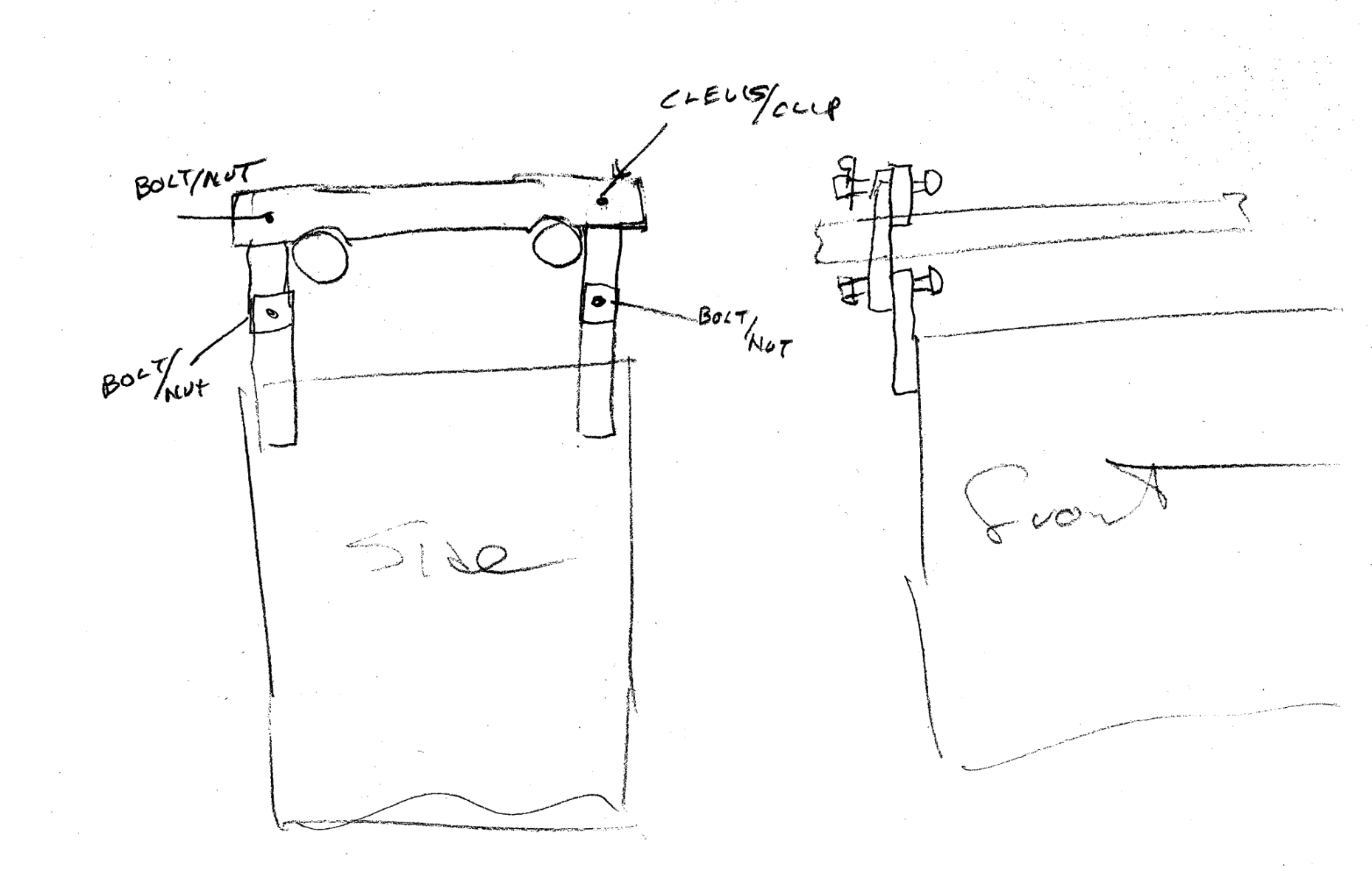

OK ideas on quick connect, how to do it.
Re: To Hang or Not to Hang?
Crude, but quick.jjbuzard wrote:JPG wrote:Quick disconnect hangers.
Ya get it both ways.
Size the hangers so it rises off the floor when the SS is raised.
Or quick disconnect nest so it is captive until disconnected.

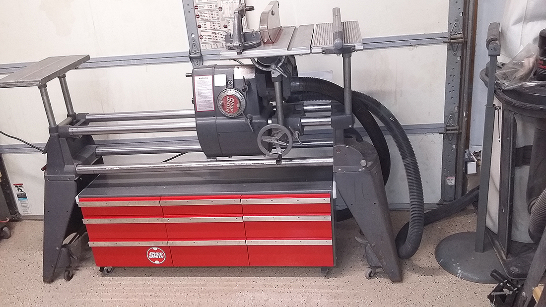

After this picture was taken I added the bigger poly wheels from Shopsmith.ChrisNeilan wrote:I would hang it, and while down there, upgrade the casters to the newer polyurethane ones. Not necessarily the larger ones (more work to change them over), you can get the poly ones that are the same size and are a direct replacement. I got mine from Shopsmith.
