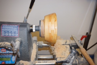

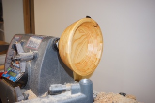

on Facebook and Youtube, Brian Gidney (Summers Woodworking) is hosting a 2 X 4 challenge. Build something with only one 2 X 4, film the build and enter by Oct. 15th.
This will be my entry, video to follow soon. I decided to make this a Shopsmith only build (except for the drum sanding)!
Three 18 segment rings, solid (Glued up) bottom, I used about 32 inches of a 2 X 4!
- seg 2x4 1.JPG (24.77 KiB) Viewed 5832 times
- seg 2x4 2.JPG (29.62 KiB) Viewed 5832 times

Nice looking piece of 2x4, can you any stain/dye to it by the rules?
- ChrisNeilan
- Posts: 1463
Re: 2 x 4 challenge!
You can do pretty much anything you wish. With all the glue joints, i was hesitant to try any dyes. There are a few gaps between the rings, very slight. Douglas Fir (at least a assume it's fir) likes to move a bit!

Save some of the chip/dust for the gaps and mix with wood glue or Supper Glue, pack in, let dry and sand out the excess.ChrisNeilan wrote:You can do pretty much anything you wish. With all the glue joints, i was hesitant to try any dyes. There are a few gaps between the rings, very slight. Douglas Fir (at least a assume it's fir) likes to move a bit!
- ChrisNeilan
- Posts: 1463
If this was a favored piece, I would do just that, but i think i'll leave it as is for now. Kinda rustic. I'm working on a feature piece for my Rotary Club- i'll be much pickier with that!

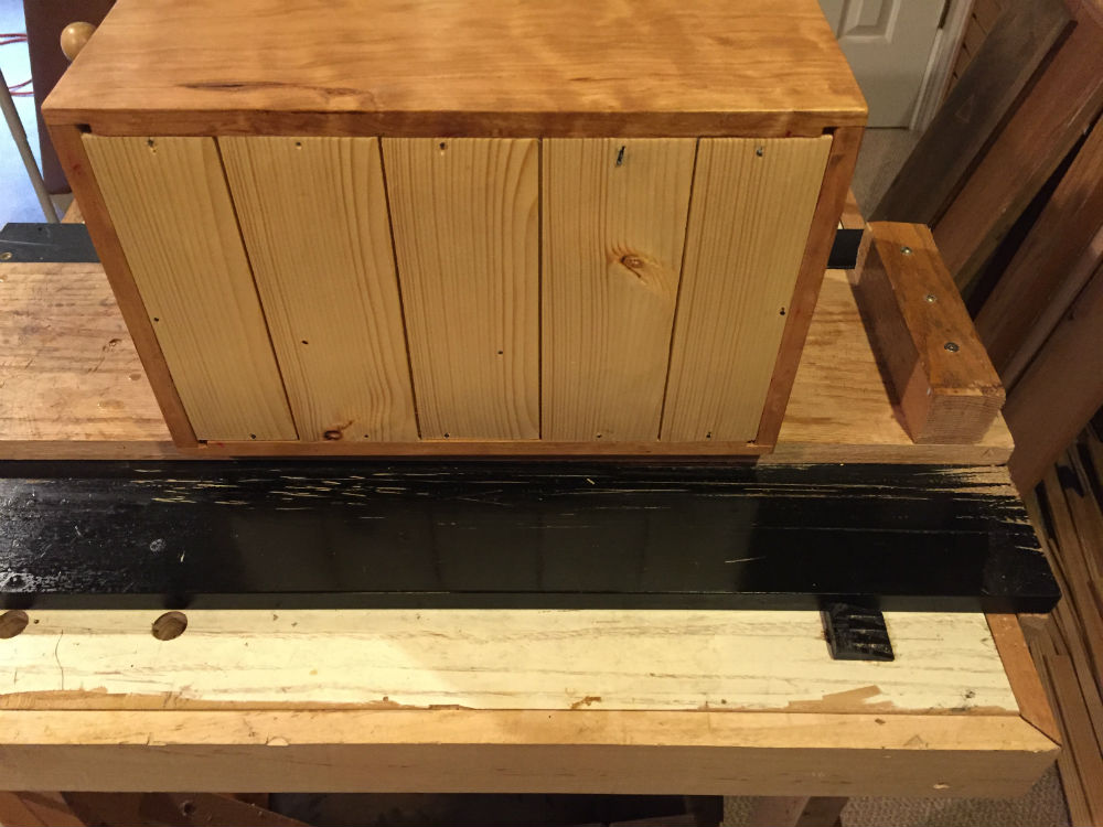

I had brief thought of that 2x4 idea lately when finishing the small cherry case I made for my niece. The back utilized a bunch of lapped boards all resawn out of a single stubby 2x4:

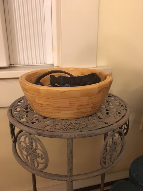

Done! A dog dish bowl for the dog's collars!
- 2 X 4 Bowl.JPG (82.63 KiB) Viewed 5619 times
