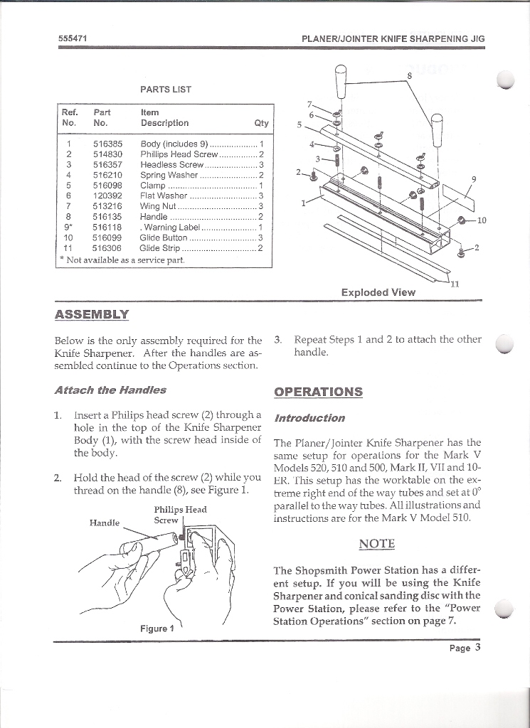

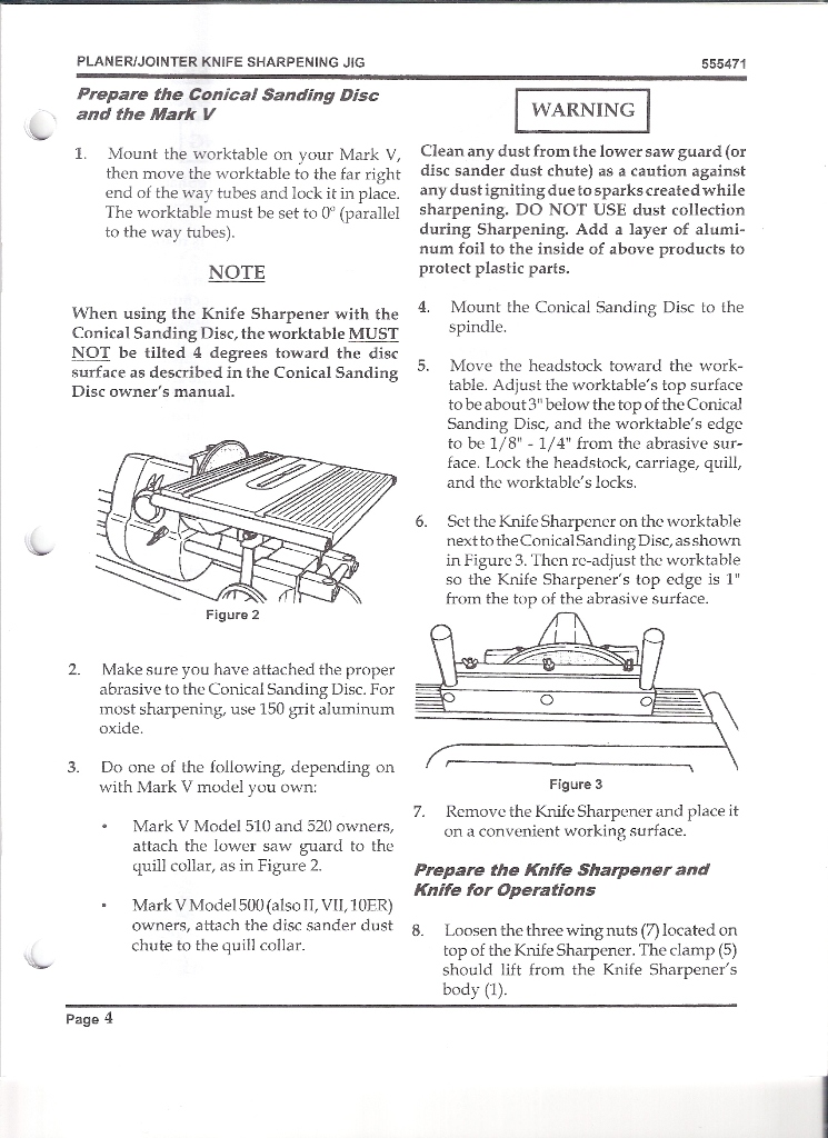

1. No the table does not get tilted.
2. The fence remains parallel to the miter slot.
3. I have no idea what set screws you are talking about. There is no mention of set screws in the instructions I have. As for tilting see 1. above. The instructions I have say in two different places not to tilt the table.
4. My instructions say to use 150 grit Aluminum Oxide paper. SS sells it, P/N 555433.
I will echo what others have said. The sharpening guide works very well and is easy and quick to use. I my opinion it is not at all dangerous. I have had it since it was first introduced and used it many times. The key is very light passes. Unless you have very dull and nicked up blade two passes or three at the most is all that is required. One thing to keep in mind when doing planer blades is to do the same pass on each blade before adjusting the table for the next pass. That way the blades will all stay the same width. It makes reinstalling the blades much easier.

I have never tilted the table with this, and have not seen where that has been even recommended.
Here's what Shopsmith says about it with the Conical Sanding Disk: "Special nylon glides on the back and bottom edges ensure the guide's smooth travel over your Mark 7 or Mark V tabletop and against your rip fence as it holds your Knives at the precise, correct angle while you sharpen them."
The point is the Disk is made at a specific angle, and the tool is designed to provide the correct angle.
Do you have the Shopsmith instructions on use of it?
Don't get too aggressive, just very light passes and you will likely love the results.
Look at where the table is in relation to the tool though in the picture.

Not according to the instructions. They say not to tilt the table in two places. I have always done it with no tilt and it works fine.
- Sharpener1.jpg (282.31 KiB) Viewed 4850 times
- Sharpener2.jpg (345.14 KiB) Viewed 4850 times
