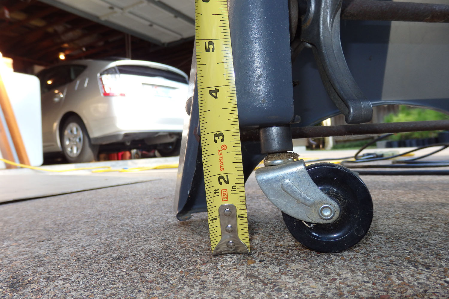

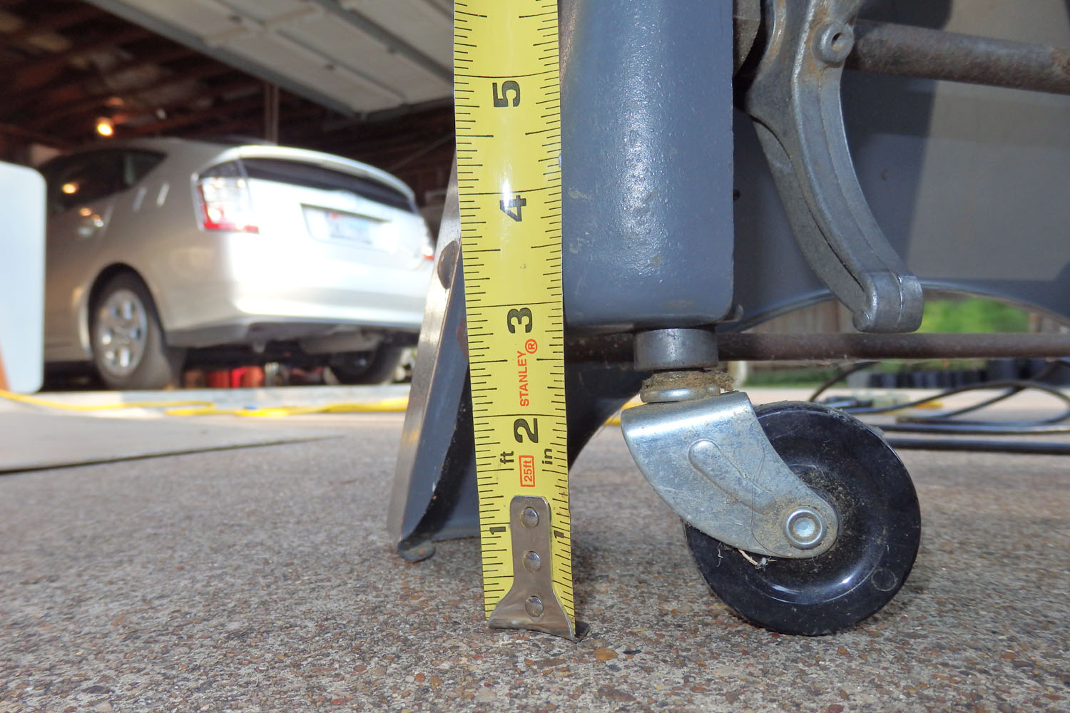

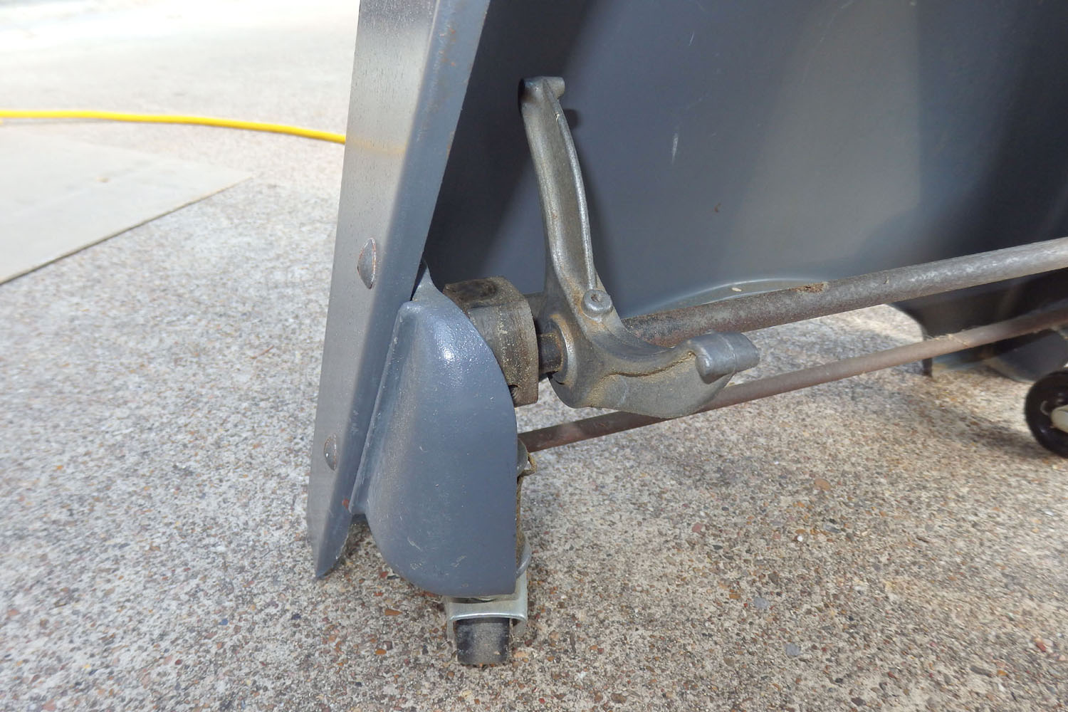

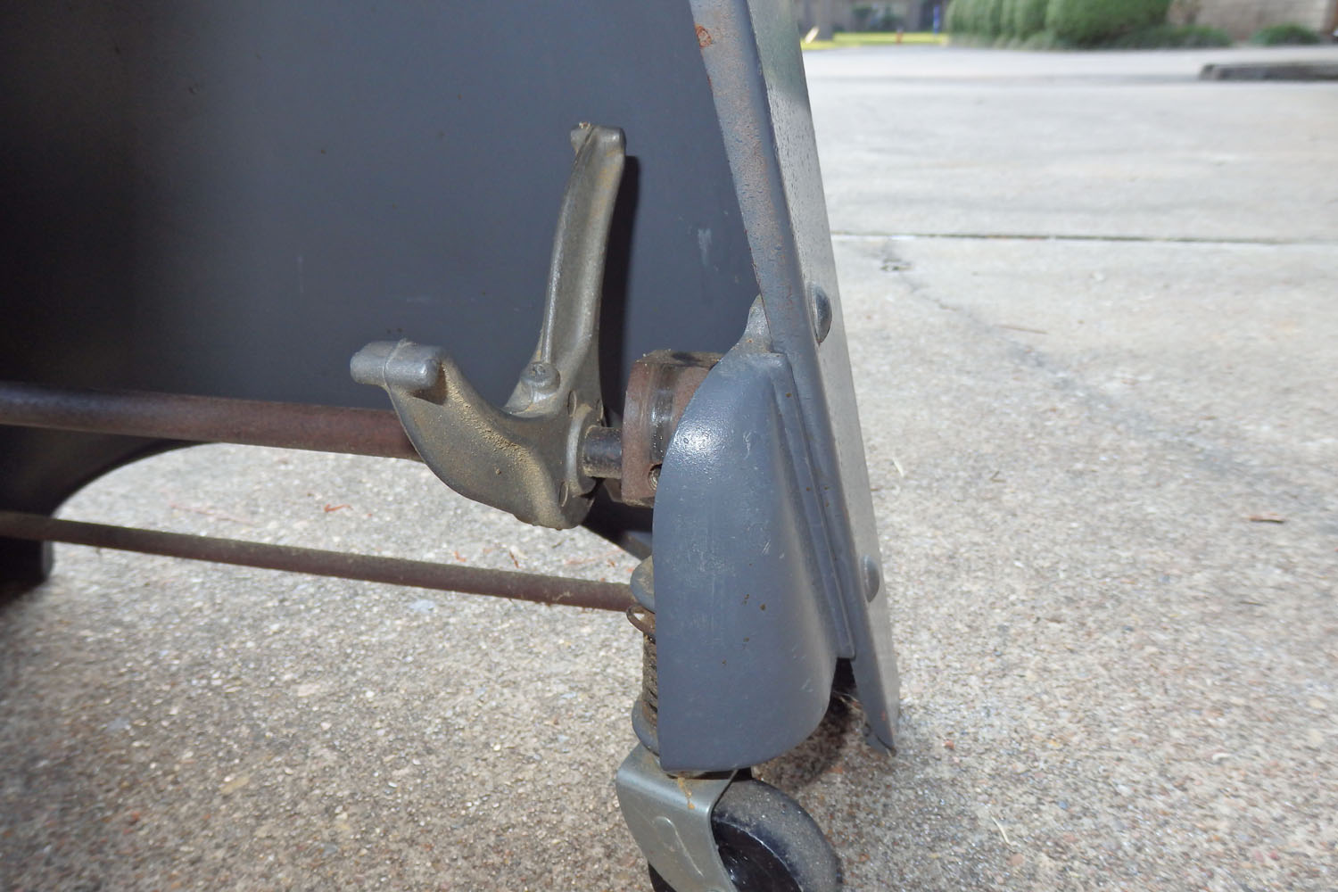

I have read similar statements in other posts about the Premium Casters, and I never have been quite sure what it meant, or if I have the older or newer casters. Mine are from about 1980. Would it be that the pedal might hit the inside of the tapered leg if the bracket was raised? Following are some pictures, so maybe someone can enlighten me. I also took pictures of my present casters in the three different positions: down, first step up, second step up. Measuring to the bottom of the bracket, the first step only raises the machine about 1/16", and the second step raises it about 1/4" more, for total of about 5/16" rise. Still investigating larger casters from Shepard to see if I can find some comparable to the Shopsmith version but maybe at a lower cost.reible wrote:Keep in mind if you have an older set of casters the levers might be to close and require you to grind the peddles or re-drill to locate the pedals or to add spacer washers to clear the pedals. If you have the newer casters set this is not an issue.

In the old days the steps were called out at "0", 1/4" and then 1/2". Looking at the pictures it seems that your casters are possibly bent. It is also possible they are not oem? At any rate the steps you are measuring are well short of what I would expect.
You have the old caster assembly. If you get the new premium casters the lever will hit.

Just look at the pictures you posted. The casters may not be bent but the stem of the caster should come down almost directly above the axle. It does not.
I believe that you would see the issue very clearly if you just removed all four casters and put them side by side on the work bench.
