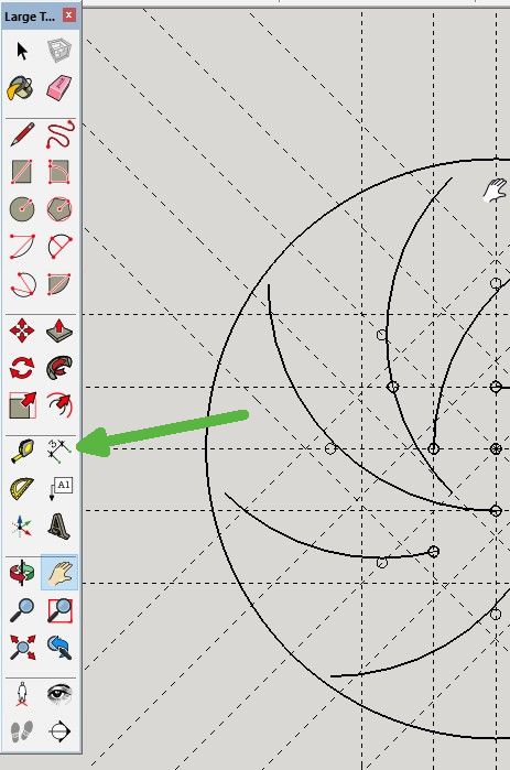

You are at the mercy of the provider of the model as to if there are dimensions or not. In some cases the drawing may look like it is correct but the dimensions may prove otherwise.
If it is not "protected" you can make/add your own measurements using the tools provided. Not sure how fluent you are in sketchup but it is this tool in case you need to know that:
