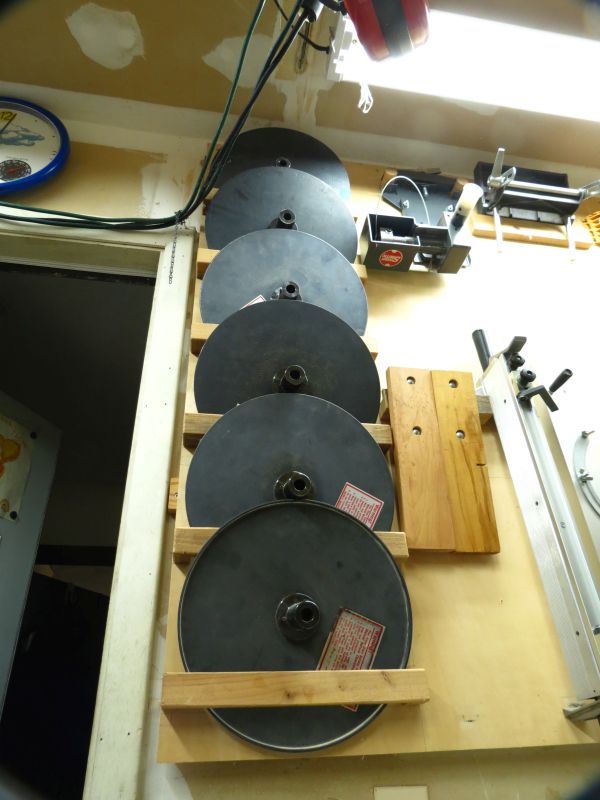

This is what my active collection looks like:

No Wonder I can't find any used disks...you cornered the market!!

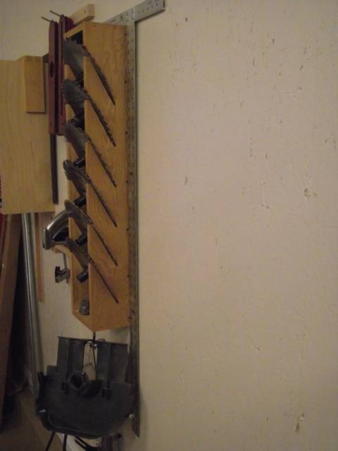

I like how you mounted the disks. Would that idea work well for the saw blades also? I have mine on a bench close to touching each other. One is in a cardboard box for protection. I like your idea.
Re: Velcro Sand Paper Mod
Yes it will. I have both my saw blades and sanding disks mounted in a similar way as Ed's arrangement.pilvr83 wrote:I like how you mounted the disks. Would that idea work well for the saw blades also? I have mine on a bench close to touching each other. One is in a cardboard box for protection. I like your idea.
