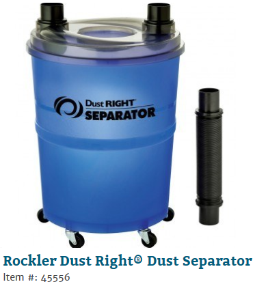

I use the Rockler Dust Right Dust Separator. I caught it on sale with free shipping a year or so ago.
I use it for everything. I can bring it indoors and use it in the house to pick up pine needles from the tree, as I did this weekend.
A buddy has a house with a central vacuum that is really powerful who swears by it. He uses it indoors between the inlet port and his pick up hose.
He ported over some piping to his workshop and uses the central vac suction to fill his Dust Separator in the shop. Sound is virtually gone based on where his central vac head is, plus nothing clogs up his lines anymore as it goes in the separator, not the central vac reservoir, which has a micro filter, and it never loses suction.
I had wondered if I might fabricate something of the sort for my shop, with a remote suction where I could roll-up and connect.

algale
Posts: 4841
Re: small shop dust collection
Post by algale »
That's interesting. I have a whole house central vac with a suction outlet in the shop. I wonder....

everettdavis
Posts: 2163
Location: Lubbock, TX
Post by everettdavis »
It would sure be worth a try on the central vac port. If the separator is working right and there is enough cfm flow to snag the large volume chips from planer output, it should all go in the DD reservoir.
They come in all sizes. There are even separator heads to fit 55 gallon drums, but you can make them with two 90 degree elbows, to adapt the original top and clamp ring. You just apply suction. Only the finest airborne particles that could remain airborne would go to the central head, presuming you didn't do two stages with an intermediate or hepa filtration element on the shop pick up side second stage.
