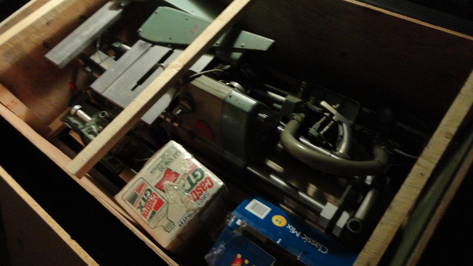

Hi my name is Wes I am new to the forum and woodworking. My back ground is fabrication in steel. I purchased a Greenie with some accessories, the ad stated "most of the Shopsmith accessories" vague but from the picture I was comfortable with the $350 asking price. The picture showed a Mark v 500 with jointer, jigsaw and two boxes of stuff. I have it disassembled and am in the process of reassembly, reconditioning each component as I go, starting from the base up. Im sure I will have many questions as I go along.

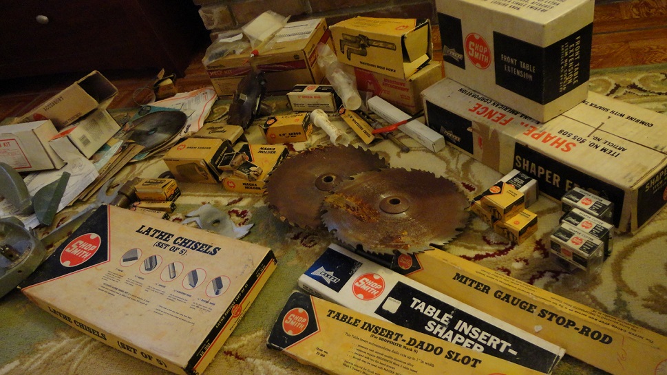

The accessories boxes were a pleasant surprise most all of them were boxed and unused, it seams the machine was used mainly for it's table saw capacity. Router arbor with bits, mortising with chisels and bits, lathe with chisels, molder head with knives, shaper fence with..... all unused in the boxes

Nice haul!!! Considering the 'shipping' container, where in the world are you(add answer to your profile).
One caveat - The Greenie main table is different from later models. The box the front table extension being a late(r) version may indicate the contents are for the later version. If so, it will not work correctly on either the Greenie main table or the narrow accessory table.
Before actually turning the motor on, perform some PM. Lubricate the movable sheaves(2)(see sticky posts at the top of the Maintenance and Repair thread).
I did not notice anything 'missing', but did notice a LOT of extra stuff.

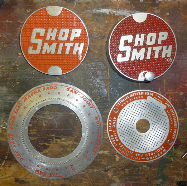

I will definitely service the headstock before operation, thanks. on that note there is no data plate on it. Is there any other way of identifying date of manufacture? I got it freight from a custom hardwood flooring company in Connecticut here in Mobile, Al.

Is there a vent plate around the idler shaft(lower one on the back end)?wesneveu wrote:I will definitely service the headstock before operation, thanks. on that note there is no data plate on it. Is there any other way of identifying date of manufacture? I got it freight from a custom hardwood flooring company in Connecticut here in Mobile, Al.
Re: New Beginning
Im not at home right now but I see that that perforated plate my very well have a number stamped on it. I do recall seeing that plate, I'll check when I get home. Like the lower right? I sold that pic from DMcCam

Fer sure it will!!!wesneveu wrote:Im not at home right now but I see that that perforated plate my very well have a number stamped on it. I do recall seeing that plate, I'll check when I get home. Like the lower right? I sold that pic from DMcCam

serial number 270508. Looks like a 1954 manufacture date.
