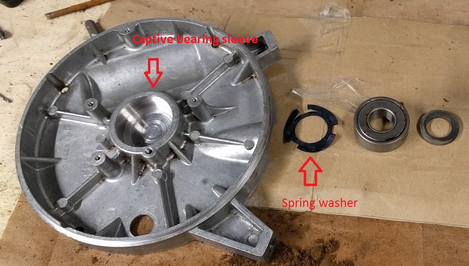

Warning! I've made up a few names below because I'm not sure what the correct terms are, namely: "spring washer" and
"captive bearing sleeve".
2. At the end of the video (here), as the motor spins to a halt, you can hear some metallic..."grinding". It's not as bad as you'd think just reading the words! I suspect it's the spring washer used to engage the rear bearing, as seen in the picture below:
The spring washer goes into the captive bearing sleeve before the bearing itself (in the order shown in the picture), the two are held in place with a washer and bolt. The sound being made makes me think the bearing is not properly held down and the outer race is being rotated (along with the spring washer).
These two issues have me pretty stumped. I'm not sure what to do about (1) except rewire everything and see if that works, maybe the capacitance value is wrong so that could be fixed. For (2), my only guess is to try and add some shims between the outer race of the bearing and the captive bearing sleeve and see if that stops it from spinning around.

A weak spring washer maybe.
The bearing should be a firm fit in the race (almost a press fit).
Re: Franklin 3/4 HP motor skipping, assembly woes
looking at the bearing bore, I think the spring is rotating and the bearing as well.
IIWM, I would slightly increase the tension of the spring against the bearing by carefully bending the fingers slightly(I assume the tension has decreased over the last 50 years).
Then I would apply BLUE locktite to the bottom of the bore where the flat side of the spring presses against it. Hopefully that will prevent the spring from rotating in the bore.
If the bearing outer race is a sloppy fit in the bore I would be inclined to apply BLUE locktite sparingly to the outer rim of the bore. The bearing needs to be able to slide in/out as the motor heats/cools.
Considering the age/wear of the motor, strange methods may be required(like above!).
If the spring/bearing are indeed rotating in the bore, it must be stopped or far greater wear will occur.
