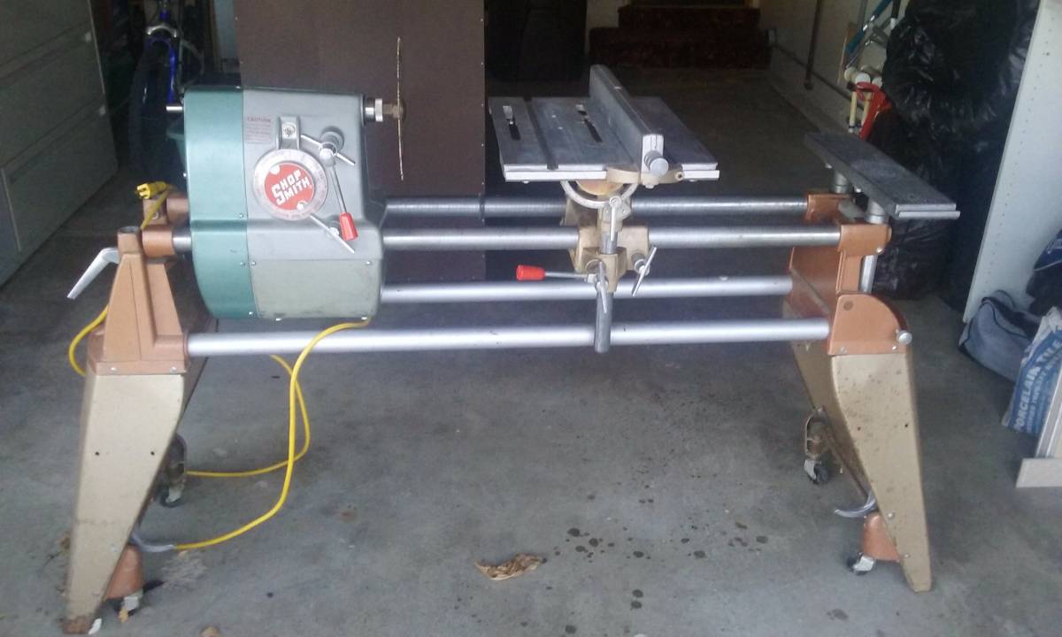

Would I be correct in assuming, then, that this is a Gilmer or greenie/goldie?

Maybe!swjones214 wrote:Would I be correct in assuming, then, that this is a Gilmer or greenie/goldie?
When 'we' refer to a Greenie or a Goldie(Brownie) we are referring to the 'original' color when it was manufactured.
Yes that picture is of a 'hybrid'. However the green part has likely been repainted.
A better indicator of whether a particular headstock is a gilmer or a poly-v drive is the vent plate surrounding the idler(lower) shaft on the backend. The gilmers had a 3/4 hp motor and all poly-v have a 1 1/8 hp motor. Again assuming all is as originally manufactured. There are other internal differences. Realize the gilmer/poly-v parts are replaceable with each other(as a complete set)*.
I hope all this detail is not overwhelming! But rest assured 50+ year old parts fit current production machine with very minor exceptions.
* the drive sleeve, quill, idler sheave, coupler/dust shield must all be one or the other version.

P.S. The headstock is an "A" casting(very early Greenie).
