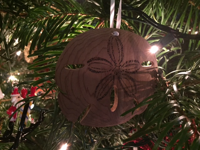

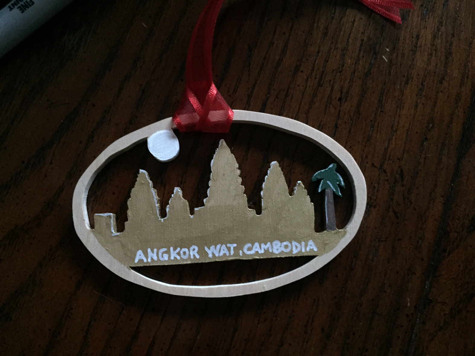

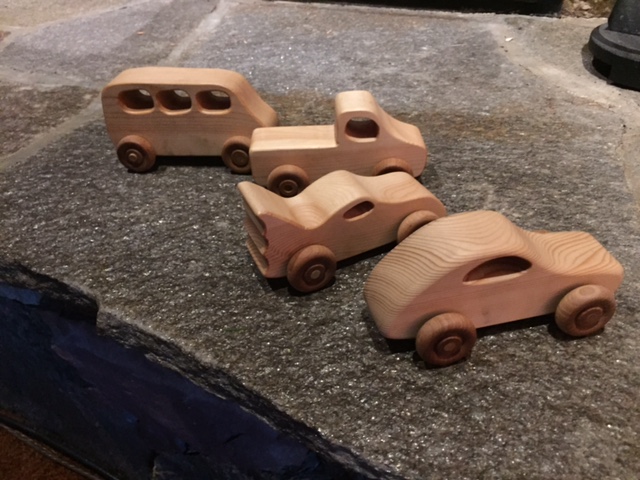

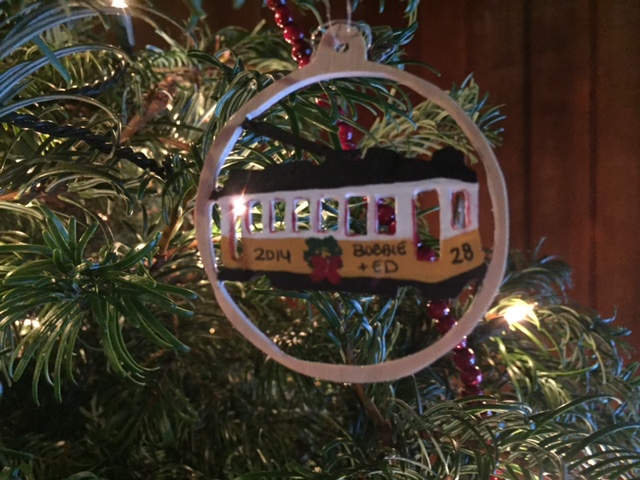

Wow, sounds like you give your machine ay more of a workout that I do! Mine gets used for making Christmas ornaments and toys for the grandkids..

ecom1: Nice ornaments and stocking stuffers. Have had the scroll saw for a long time but only used a little bit until now. Just couldn't stop on the picture frame once I got started.
