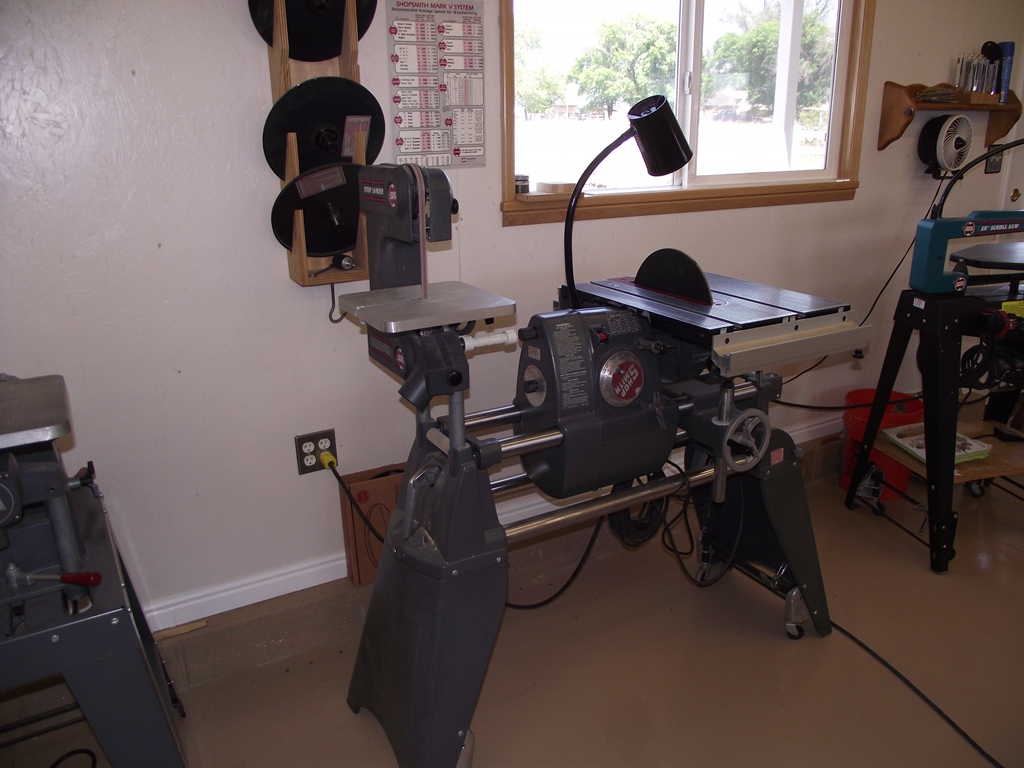

JPG has some interesting points but maybe some of them are not to relevant to the over all scheme of things (sorry James). I built a shorty. When I built it the intention was not a sanding station but that is what it has turned out to be. If you intend to keep the main table carriage on then only cut off 18". That is my opinion. It gives you just enough room to couple your SPT's on the left end. If you want a shorty without the main table/carriage then shorter is possible.
- DSCF1168_Small.jpg (294.03 KiB) Viewed 12157 times
Re: I want to make a mini/midi for sanding
Thanks for all three responses. Jsburger, you have a very clean workshop. Your machine is kinda what I am looking to do...except I'll have a 500. I'd I do this, I'll have all SPT'S on a place and ready except for the scroll saw which has a broken part that isn't available anymore and I need to come up with a repair.
Thank you all.
Thank you all.
There is no problem doing the same thing with a 500.ibskot wrote:Thanks for all three responses. Jsburger, you have a very clean workshop. Your machine is kinda what I am looking to do...except I'll have a 500. I'd I do this, I'll have all SPT'S on a place and ready except for the scroll saw which has a broken part that isn't available anymore and I need to come up with a repair.
