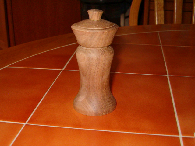

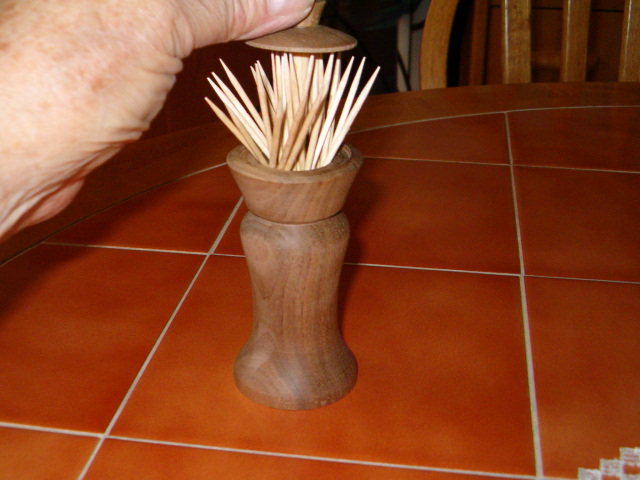

Had a little time on Saturday, so turned out a toothpick dispenser. Got the idea from the latest Wood Mag. Had a piece of walnut that I ruined for a pepper mill by cutting out a deep part where it didn't belong. Although it was too small for the size shown in the mag., I went after it anyway. As it turned out the shape of the top is about the only thing that resembles the magazines sample. Saw no need for the fancy finial they used, so made a smaller handle.

[ATTACH]1705[/ATTACH]
[ATTACH]1706[/ATTACH]

Post by kd6vpe »
Charlese,
What a great idea. I really like that little thing. Is there a disk of wood at the bottom of the dowel that pulls the toothpick up with the top? I have some scrap about that size that I want to try to do the same with. It would be useful.:)

Nice project, Chuck! Nice fit on the top! I saw that plan also and thought it was, at the moment, beyond my capabilities. I think you've now inspired me to give it a try sometime. Thanks!

kd6vpe wrote:Charlese,
Actually there's a little cup on the bottom. The plans said to drill a 1 1/4" hole 3 3/8" deep. My holder was too narrow for this, so I drilled a 1" space. Then turned a 1"+ cylinder about 1 1/4" long. Then sanded the cylinder so it fit into the 1" hole in the holder. Drilled 5/8" diameter, 1/4" deep into the end of that cylinder. Then drilled 1/4" - 1 1/4" deep, to hold the dowel. Parted the cylinder to leave 1/2" and eureka! - there's a 1/4" deep cup with a 1/4" thick bottom. The sides are very thin but it works, and beats the dickens out of digging into a box of picks!
