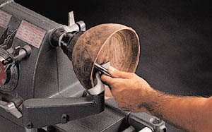

I a having difficulty turning the inside of bowls that are about 4 or 5 inches deep and about 10 inches in diameter. The tool rest holder is angled and won't allow me to get below center of the bowl to shape the bottom. Any help would be appreciated. Thanks Larry

If I understand you, the tool rest holder itself is physically interfering with getting below the center line. Is the bottom of the tool rest holder hitting the rim of the bowl? A photo of the situation would be helpful. If you have a 510/520/Mark 7, the tool rest holder has two mounting positions, and that may help resolve the problem.

You might like the specialty 'S' bowl tool rest. 555312 It's about $37.00
Bowl S Tool Rest 555312.png (107.29 KiB) Viewed 10758 times
Couple it with a Tool Rest Upgrade Kit 521765 for 500 or 514264 for 505-520 They are about $30-$40 respectively and not having to tweak the allen screw when you need to is a big help for bowl turning where you are adjusting the tool rest as the profile changes.

I probably did not explain myself very well. the picture that evert posted is showing the tool rest upgrade and it appears to be a lot like the one I have. The angled part of the tool rest holder is angled and hits the rim of the bowl not allowing me to reach below center of the bowl. I have the S tool rest and it will not allow me to shape the inside of the bottom of the bowl, again the angled bottom of the tool rest holder hits the rim. the bowl I just finished is about 5 inches deep. I am looking at building a tool rest holder that fits in the end were the end supports fits in the two holes for the band saw and other accessories. I think I can attack the bottom of the bowl with a short straight tool rest holder that will allow me to get below center and to the walls of the inside of the bowl. Thanks for the help. I appreciate any help I can get. Larry

Remove the tool rest support arm and turn it upside down.which hole is being used? Try the other one.

I am using both holes in the tool support depending on angles and depth I need. I am truing to put the tool holder and rest inside the bowl so I can finish the bottom inside of the bowl. I cant seem to get close enough to avoid chatter and get a good finish unless I am doing something wrong. If I build what I am thinking about it will allow me to attach the bottom of the bowl with the tool rest parallel to the bottom of the bowl. Any Ideas with pictures would be helpful. Thanks Larry
