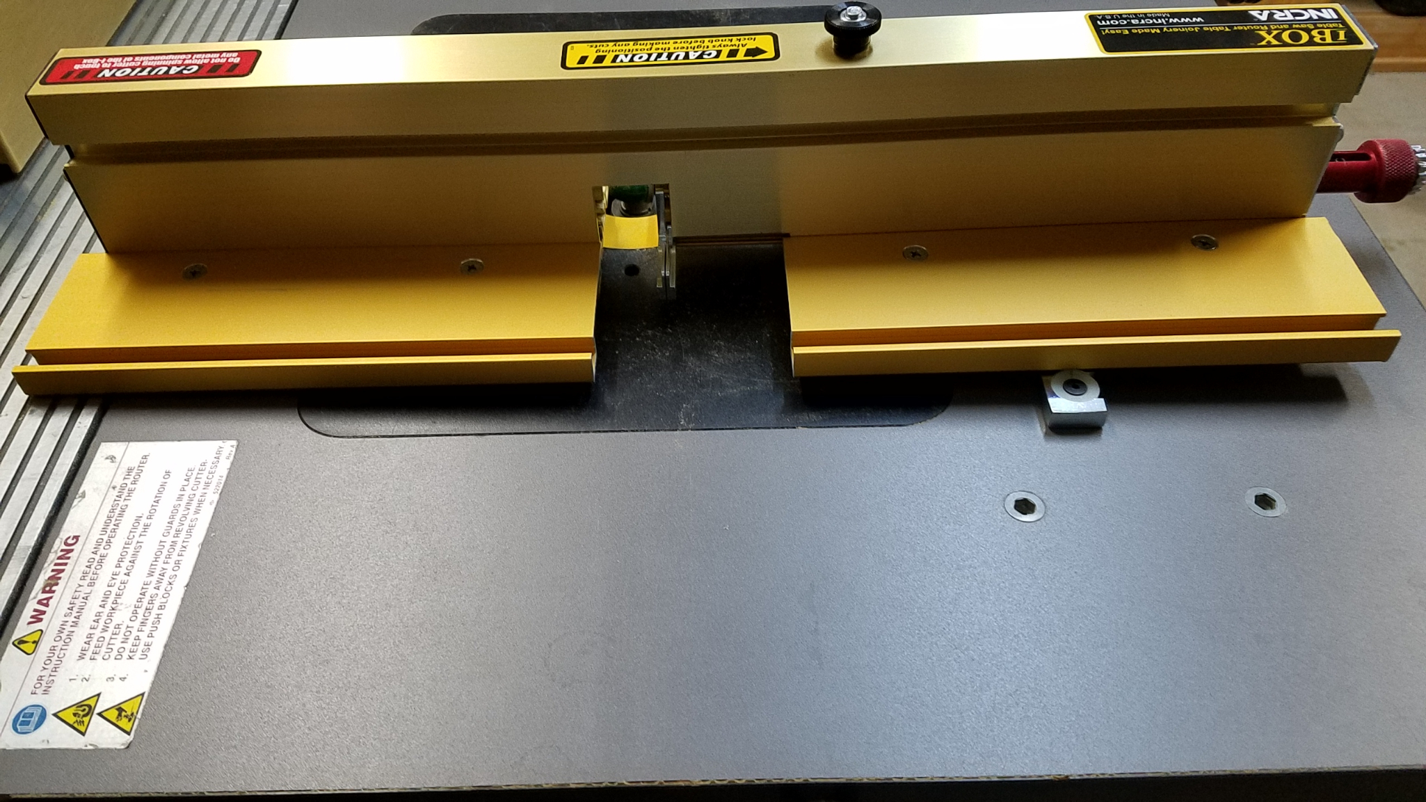

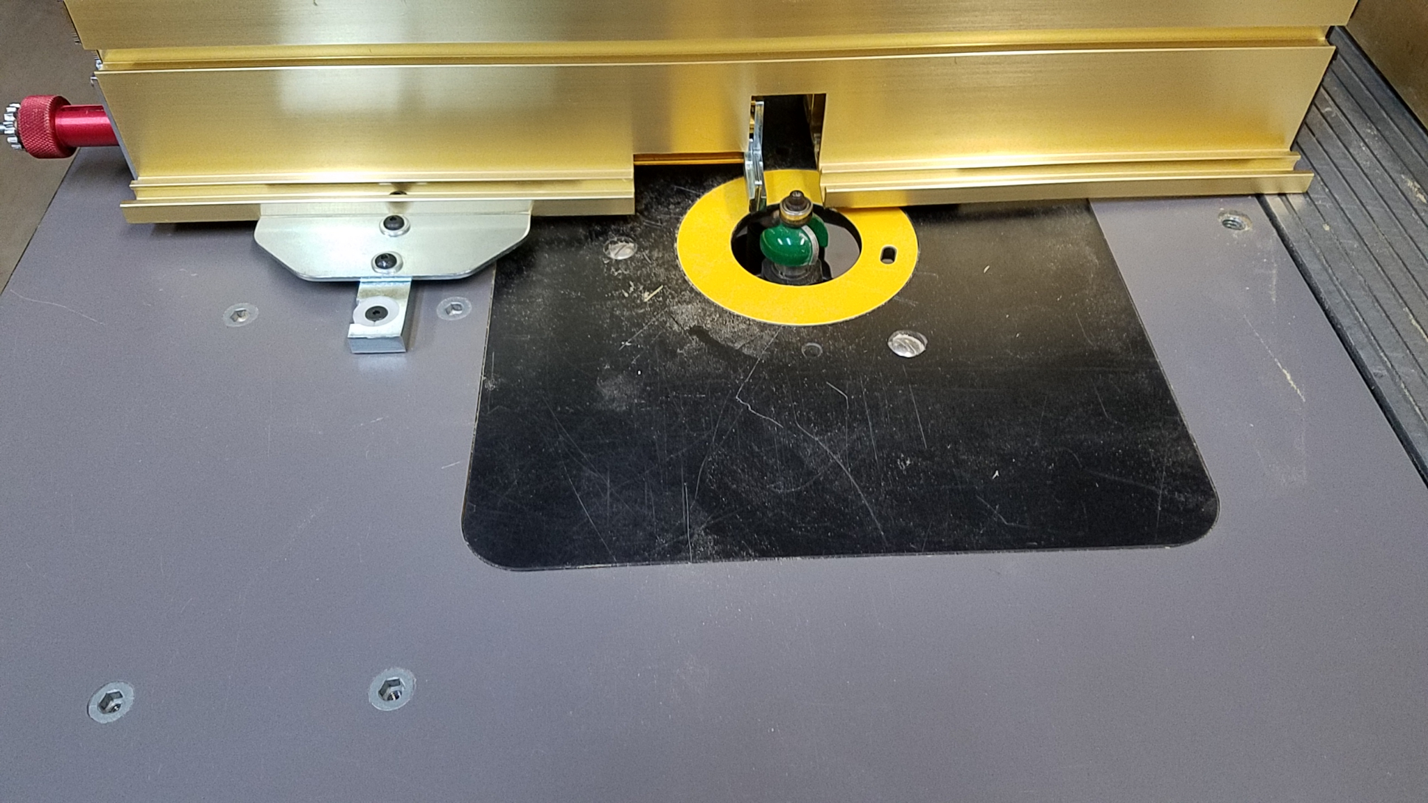

if I install a miter track where one would be needed on this router table?
Am I flirty with disaster if I do this.
I have an extensive set of router bits and would not have to invest in finger joint or dado blades.
NOT to be used with router bit shown.
- Miter Track to Router Table 002.jpg (1.59 MiB) Viewed 12255 times
- Miter Track to Router Table 003.jpg (1.84 MiB) Viewed 12255 times

JMO Dusty, but I wouldn't do it. But, I use a dado blade in the TS for the I Box.
In the 15 years of using the RT, there has never been an instance where an operation couldn't be completed because of the lack of a miter slot.
The OAR has a miter slot that is never used, either.

I don't think it would hurt your table but routing box joints creates a huge mess. At least with Dado blades you can contain a lot of it.

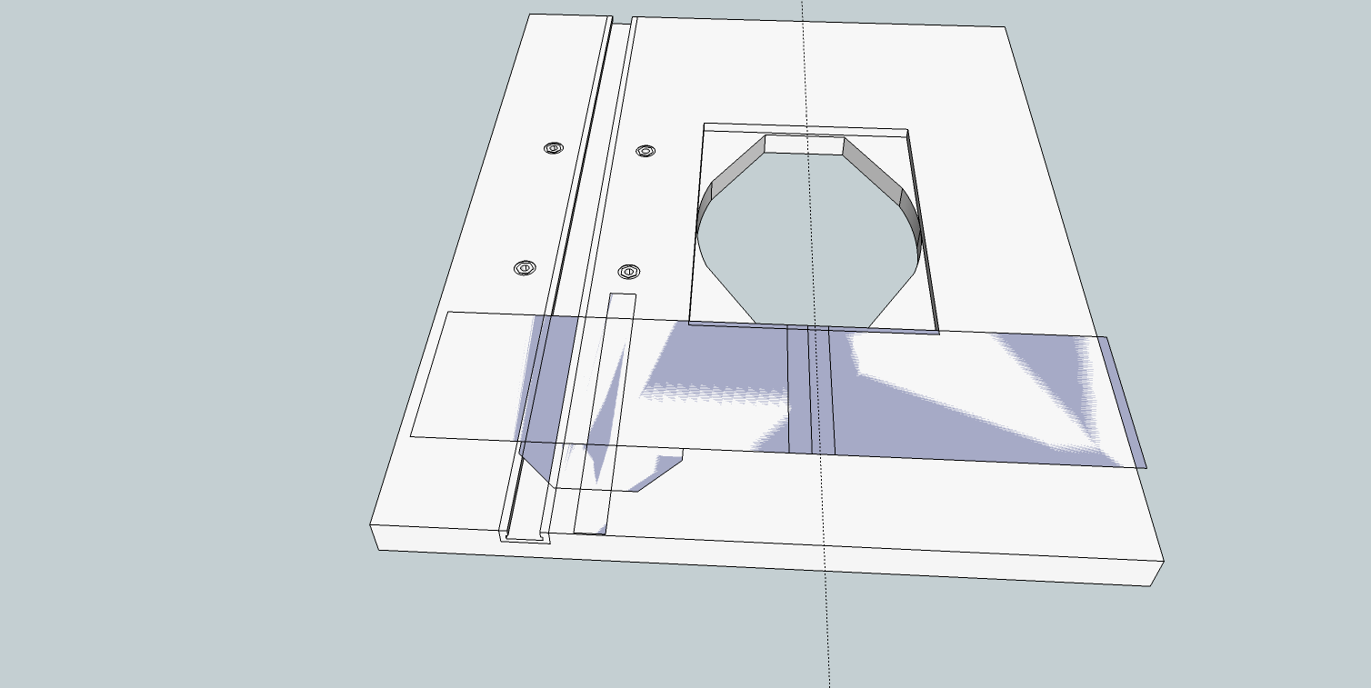

Here are two of my sketchups, one superimposed over the other. The drawings are to scale. The I-Box is drawn with the miter bar located as I have it set for the Mark V in table saw mode. Some coincidence.
My original router table is stowed away somewhere in the shop and I need to locate it. I know it needs new edgebanding but that is a small factor.
