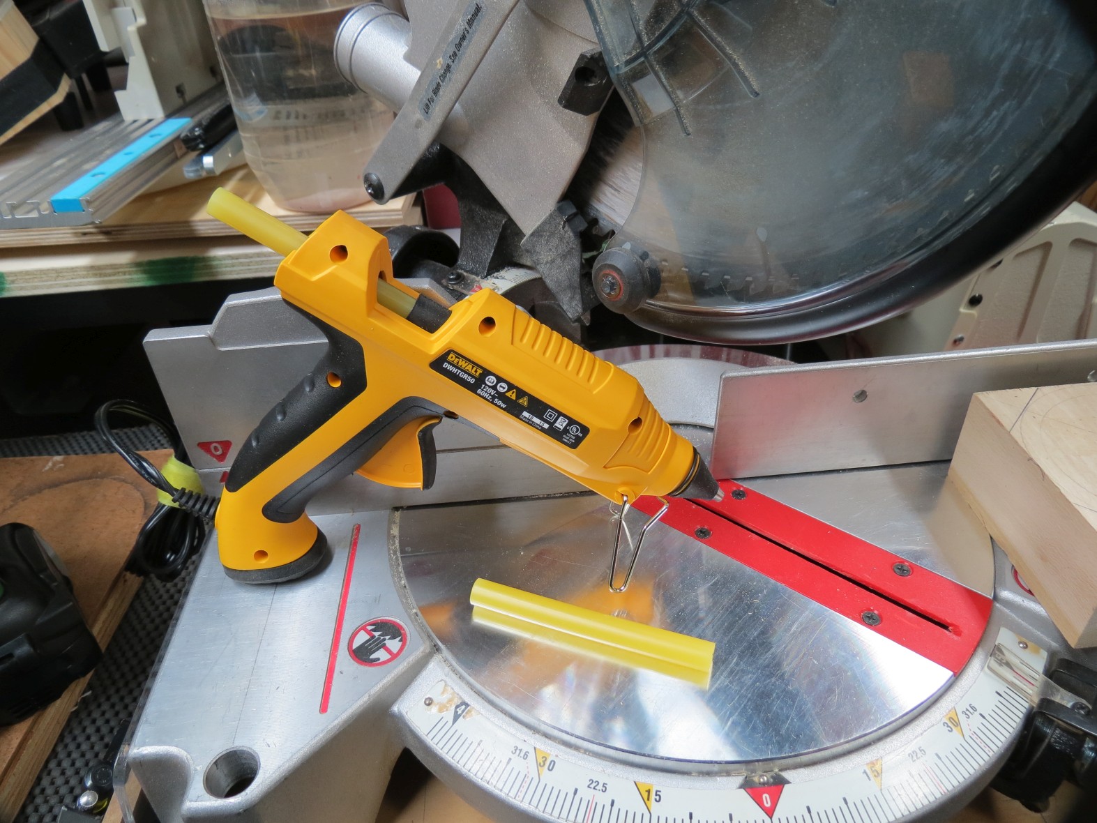

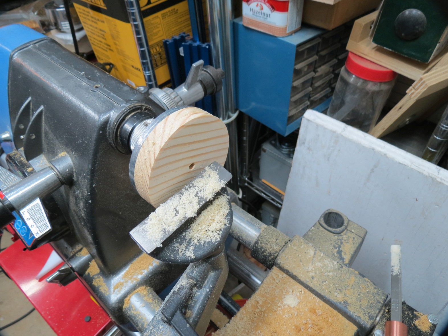

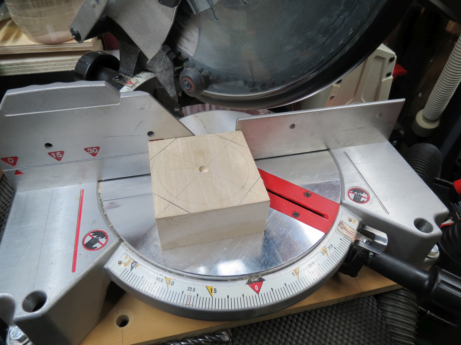

I've never attempted it but I getting ready to. So far I'm planning on using this glue gun:

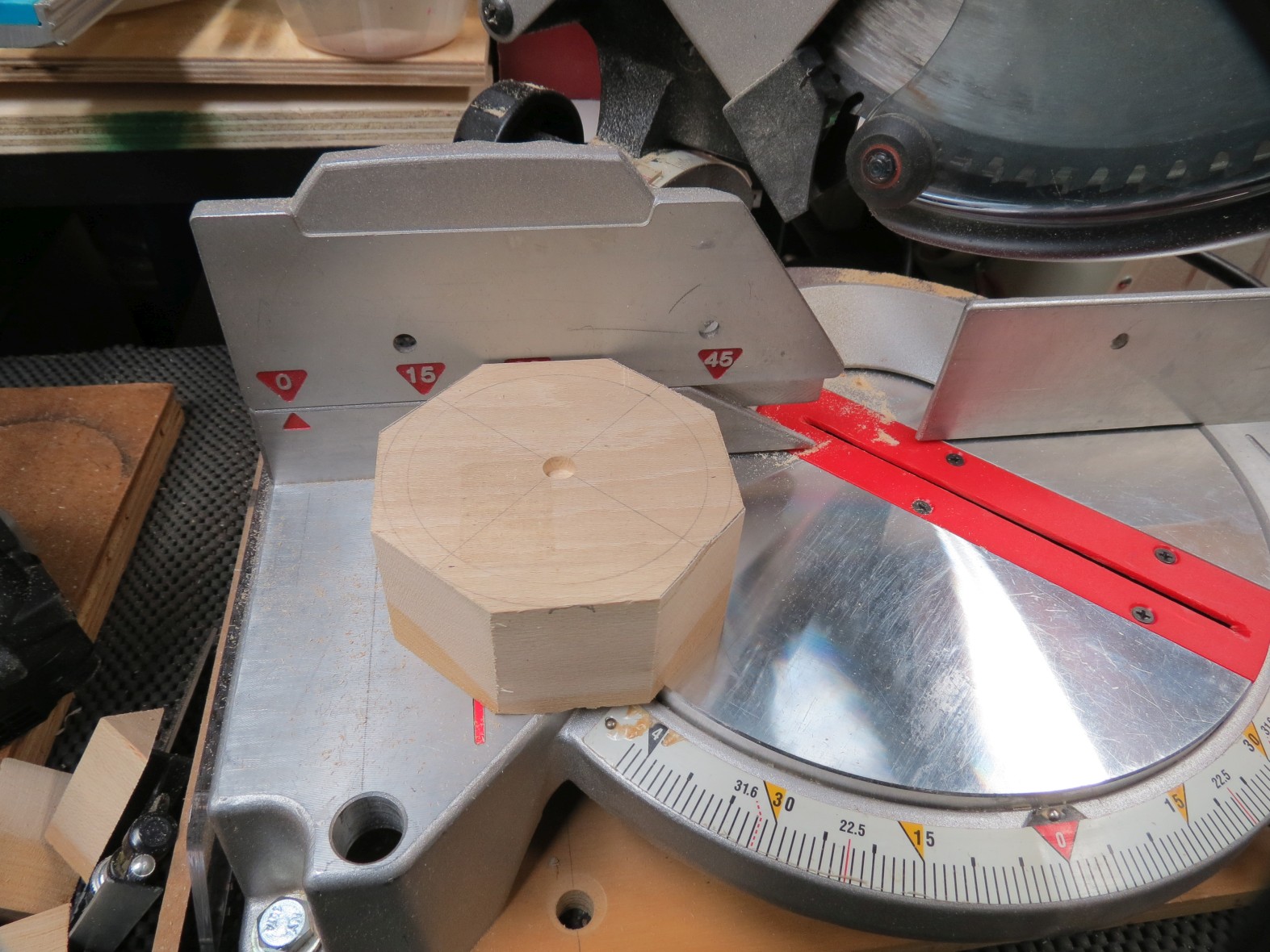

This is the blank:
I've octagon-ed it:

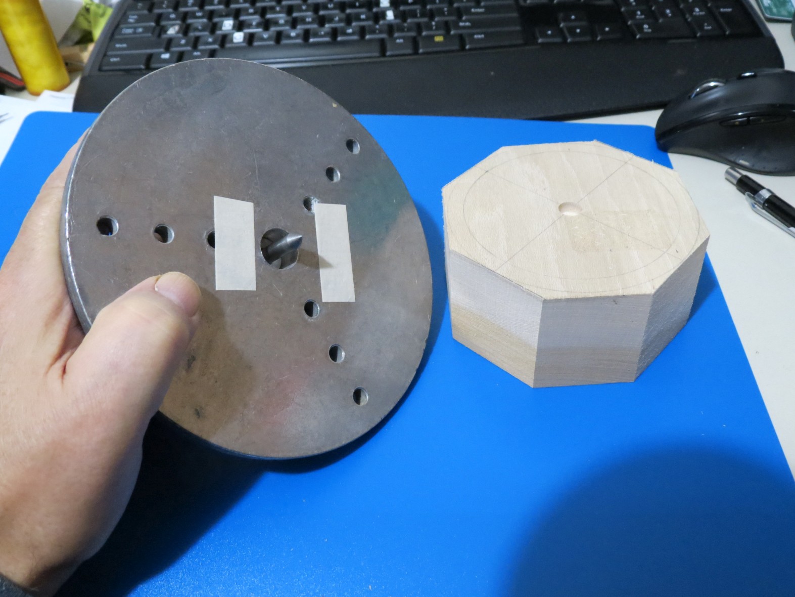

On the face plate side I've made a very slight concave block where the glue will meet the blank.
I've I have the blank and face plate and glue gun inside warming to room temperature so that I can try and attach it tomorrow. I plan to round between centers, the center hole in the blank is where I'll be removing material.
So any comments before tomorrow happens, I know some here have said this works, I'm trying to be a believer but I have to admit I'm worried about getting hit with block of wood............

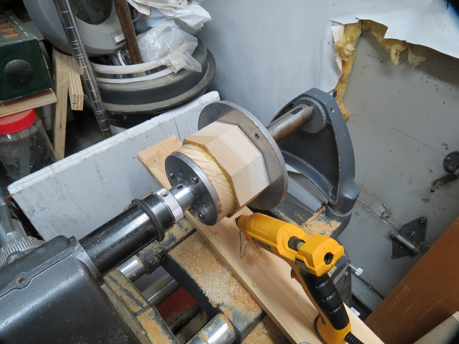

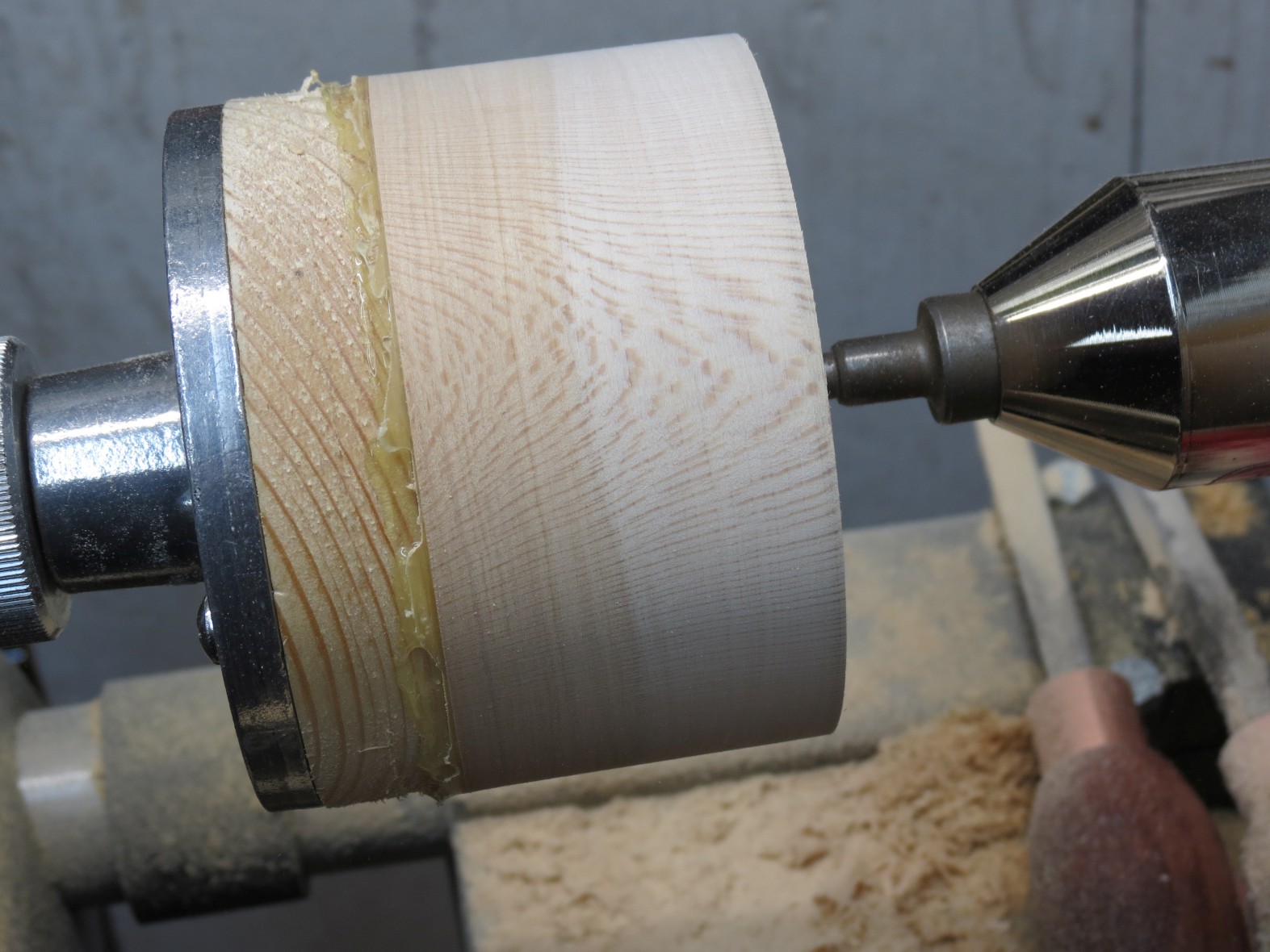

I wasn't able to get to this until this evening, had a lot of other stuff to do today. I have a few more pictures that I took to document what I did. One of the things I mentioned yesterday was the small hole in the blank on the side I was going to hollow out. I had that because I wanted to get the waste block and work piece centered on each other. I have a part that fits the 5/8" hole in the faceplate and has a rod centered on that part. So if I use that and find the center hole on the blank then things are pretty well lined up. Here is a picture of how I did this:
Note the double sided tape to make sure the work piece stays centered.

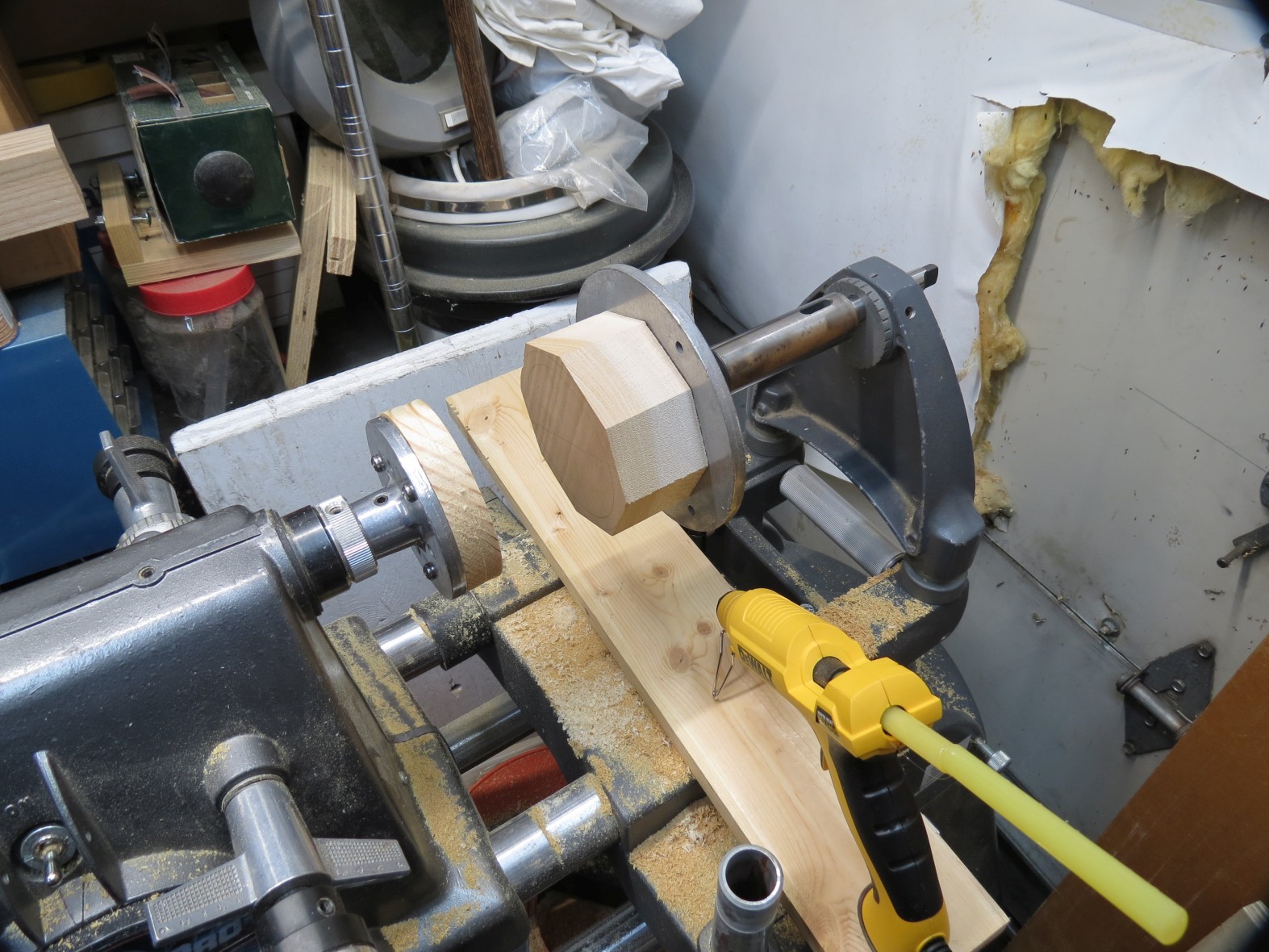

Next I added a MT2 extension to the tail stock so I could use the quill to apply and hold pressure to the hot glue joint. Here it is in the test position:
I took of the face plate with the waste block to put the glue on then slipped it on the quill and applied pressure. That looked like this:
I added the extra hot glue around the exterior. Waited about a half hour then set up the live center and proceeded to turn the blank round.

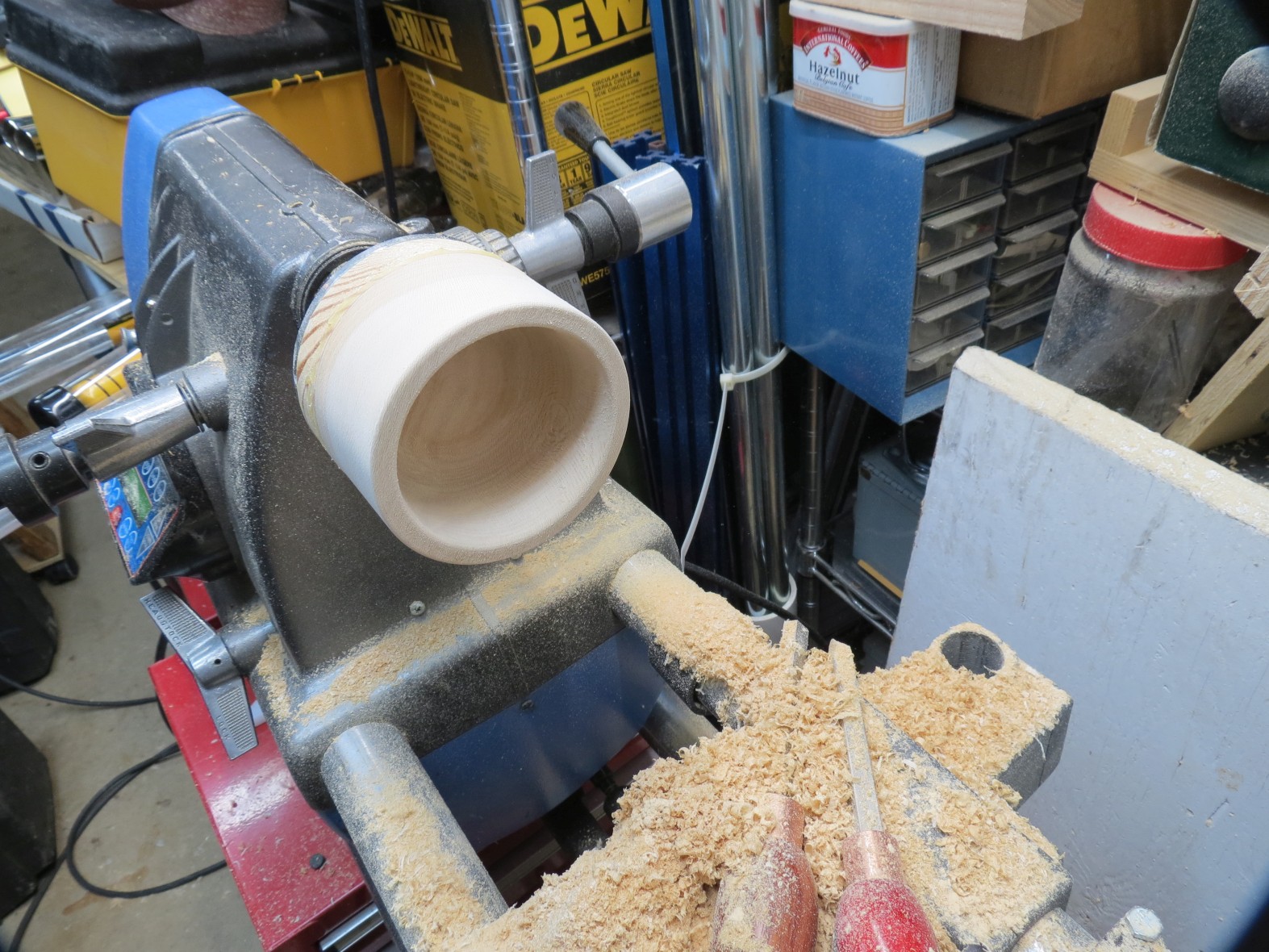

I then went on to remove the live center and started hollowing.... well yes I did check to make sure it felt nice and tight. Now I'm to the point of starting the sanding so the glue has held for the stressful portion of the turning.
So that is about it for this test.
