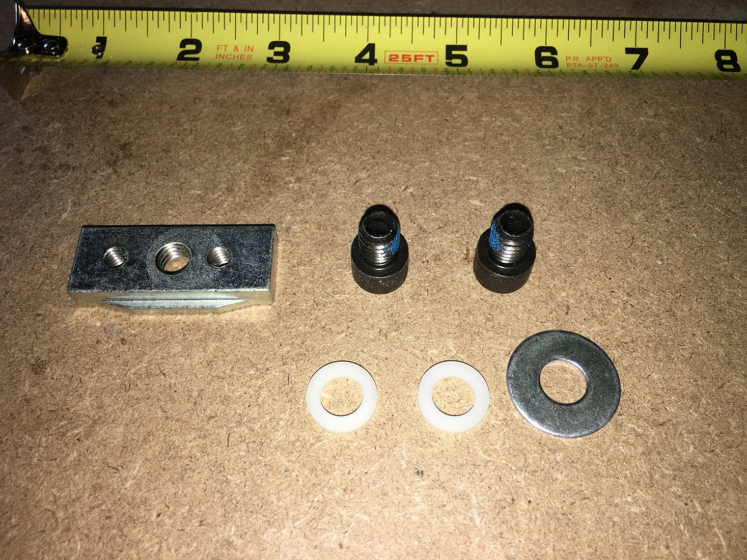

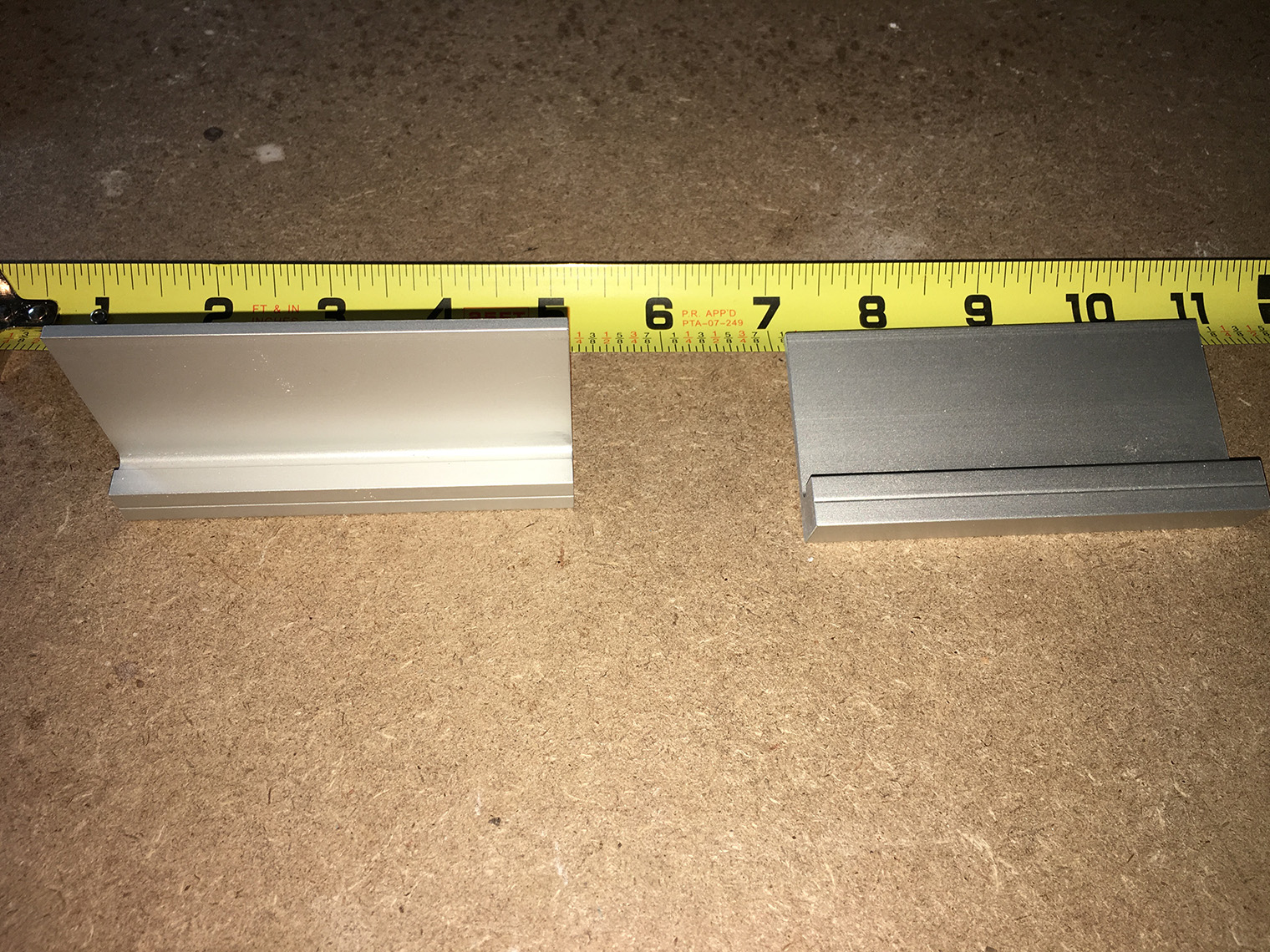

Hello forum friends,
Some of you may remember me from my recent questions about making angled cuts on the table saw, and problems with my sticky miter gauge. I have a brand-new Mark 7, and I've been doing a lot of basic stuff for the past two months - using the table saw to cut some shelves, building a workbench and a French cleat system, and a few projects with the band saw and drill press. Today I was going through all the stuff that came with the Shopsmith, and I came across a couple of things that I couldn't identify from the owner's manual. There are two little aluminum pieces that look like they should hook on something, and then there is a single T-nut with a couple of bolts and washers. I know that T-nuts are used to set up jigs on the fence, but it seems that you would almost always want two for any jigs I would use (I plan to buy a few from the Shopsmith site soon). But what would I do with one T-nut, and what are the little aluminum things for? As always, any help from the smart crowd would be appreciated!
Ken
Mystery aluminum things
Aluminum things small.jpg (706.93 KiB) Viewed 21355 times
Lonely T-Nut
Lonely T-Nut
T-Nut small.jpg (760.81 KiB) Viewed 21355 times

I am not sure what the T nut is for but the Aluminum "Thingies" are for aligning the 520 table rails to the table.

Thanks! I bet I can find something in the alignment chapter about how to use them to align the table rails.

I'm not sure but the T-nut may be part of the table-mounted shaper shield.

I believe the screws and washers mat be to mount the dust collecting elbow to the drum sander table insert.

kkoyle wrote:Thanks! I bet I can find something in the alignment chapter about how to use them to align the table rails.
I am not sure you will find anything describing how the aluminum jigs are to be used. There was a flyer that came with the jigs when purchased but I cannot locate mine.
However, a picture or two should explain everything. They are nothing more than a gauge to be used to position the 520 rails so that they are ALL the same distance below the table surface.
View this thread. There are a couple pictures of how I used them.
http://www.shopsmith.com/ss_forum/viewtopic.php?t=2371
