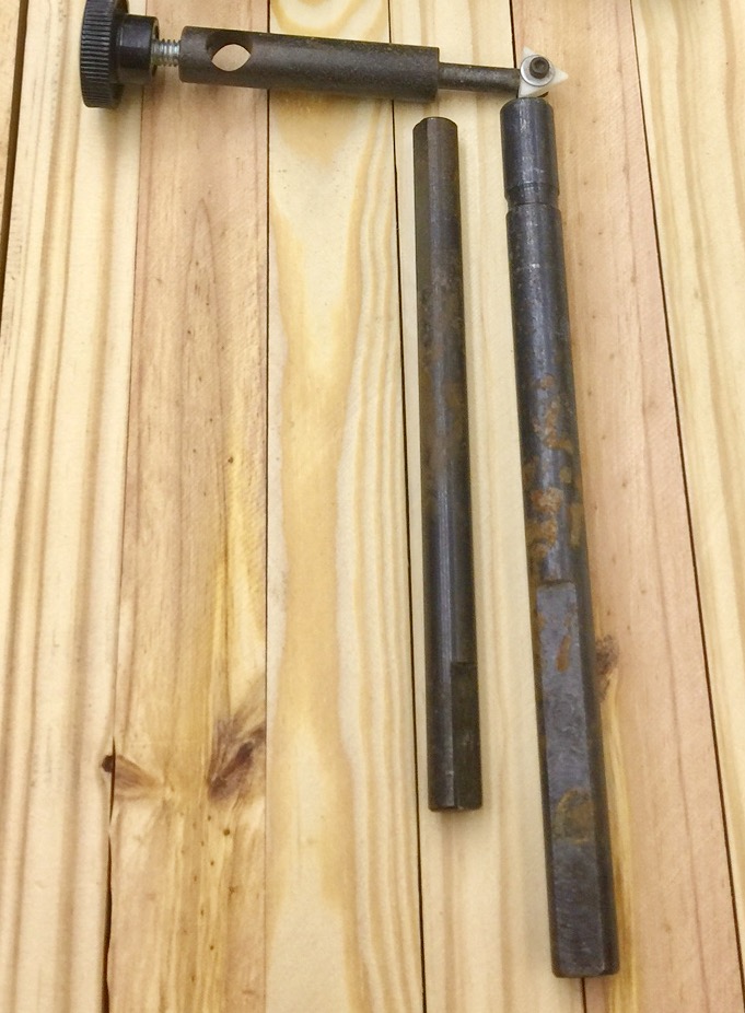

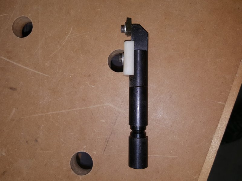

I purchased this lathe duplicator from an auction but these don't look right. I think I have the wrong cutter support. The part I have is longer than the one pictured in the parts diagram. Any idea what this is for?
- IMG_1577.JPG (312.63 KiB) Viewed 3244 times
- IMG_1576.JPG (307 KiB) Viewed 3244 times
- The part on the right is what I am not sure of
- IMG_1578.JPG (146.76 KiB) Viewed 3244 times
Re: Lathe duplicator parts missing?
Not only longer, but appears to have a larger OD.
Not a clue have I.
Not a clue have I.

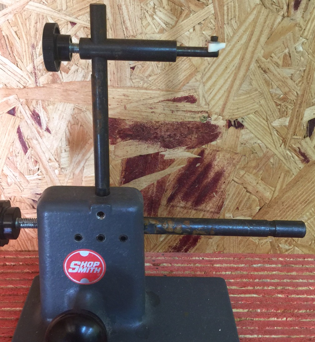

Perhaps if you check this page it might help:
http://www.shopsmith.com/service/lathe_ ... iagram.htm

It looks like I was right about the cutter support being wrong.
But what in the world could the shaft that I have be for?
Just about anything else in the world.
Oh btw, welcome.
Oh btw, welcome.

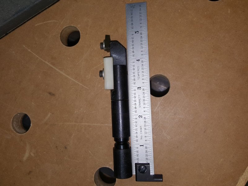

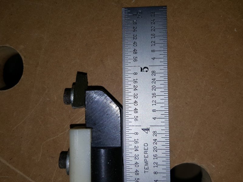

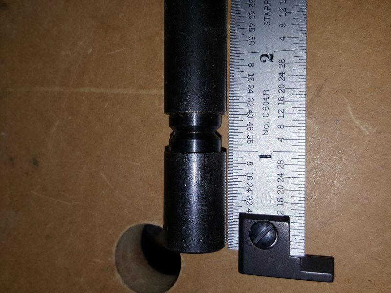

Man, if you could get some pictures, I would be grateful. I have google search images for a while and I cannot find a close up picture of the actual cutter support I am suppose to have. After checking the price of a new one ($85), I was thinking of building one from this mystery shaft I have. If you do happen to have time to take a picture, could you lay it beside a machinist ruler in the picture also?reible wrote:Hello and welcome to the forum!
If you don't find what your interested in I can dig out mine and take some pictures, let me know.

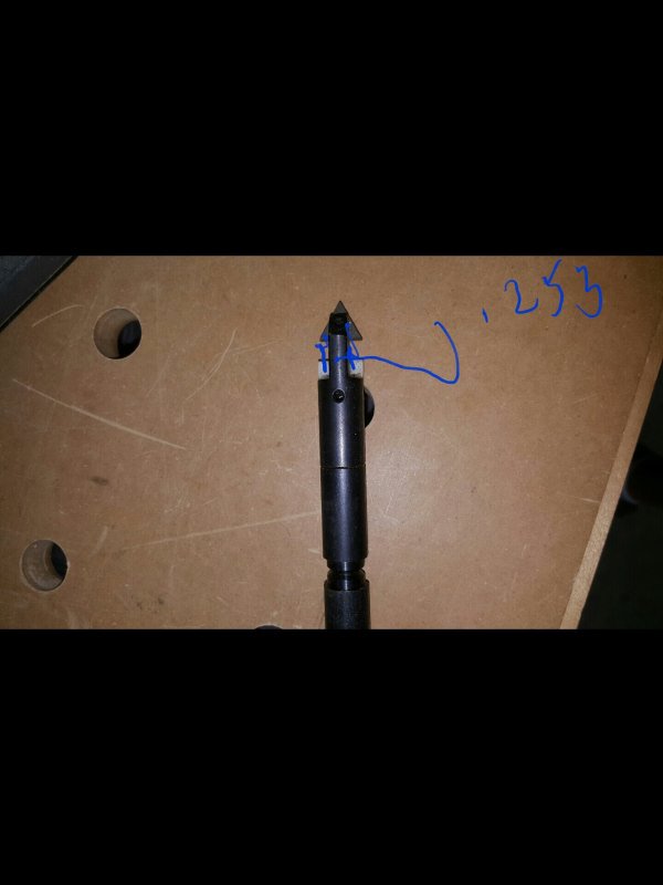

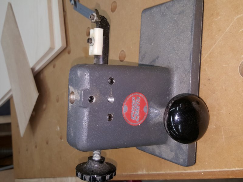

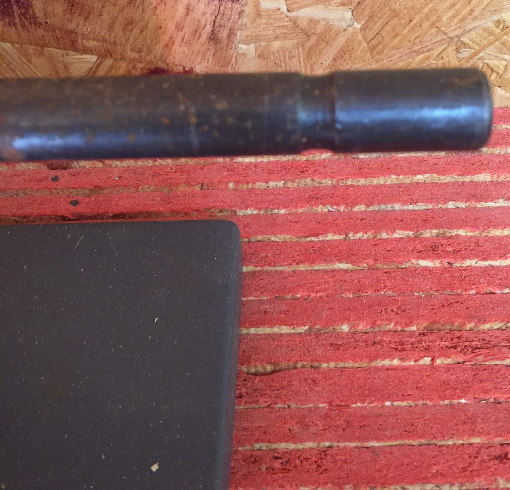

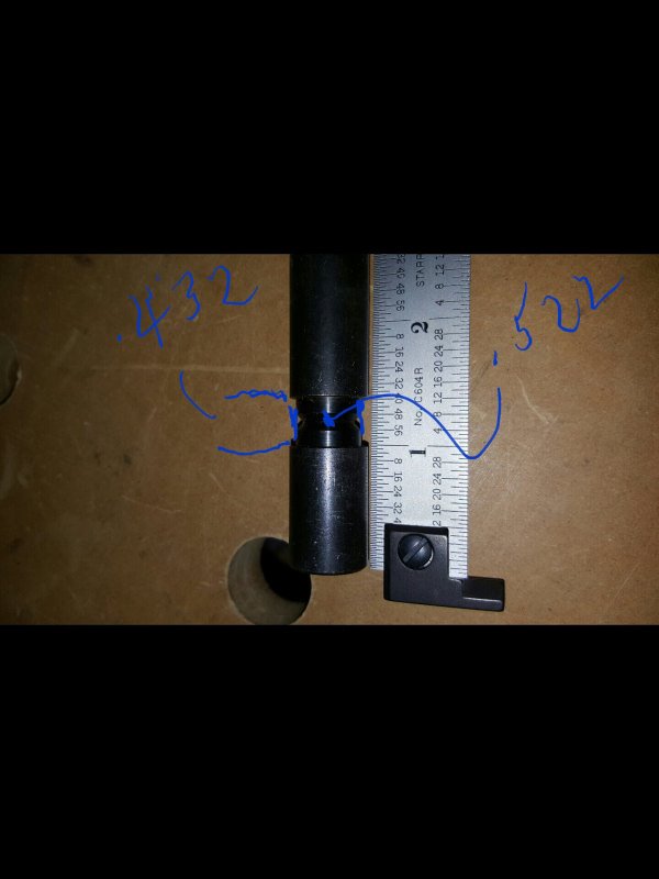

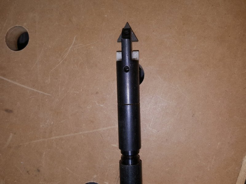

Here are some pics. Let me know if you need any other measurements or pictures.
Jack
Jack
- 2017-01-25 21.05.42.jpg (70.28 KiB) Viewed 3174 times
- 2017-01-25 21.06.28.jpg (70.75 KiB) Viewed 3174 times
- 2017-01-25 21.06.40.jpg (67.89 KiB) Viewed 3174 times
- 2017-01-25 21.07.19.jpg (77.59 KiB) Viewed 3174 times
- 2017-01-25 21.07.29.jpg (90.07 KiB) Viewed 3174 times
- 2017-01-25 21.07.52.jpg (82.37 KiB) Viewed 3174 times

claimdude wrote:Here are some pics. Let me know if you need any other measurements or pictures.
Jack
wow thats helpful. I have the same starret rule with a stop. I am going to give it a go. I wonder if I could use the shopsmith lathe to mill it down. Maybe I could use a grinder while it is spinning in the lathe.
gnarlyleech
- Bronze Member
- Posts: 5
- Joined: Wed Jan 25, 2017 8:23 am
The shaft is .600".
I've got some work to do but I think it is do-able.
