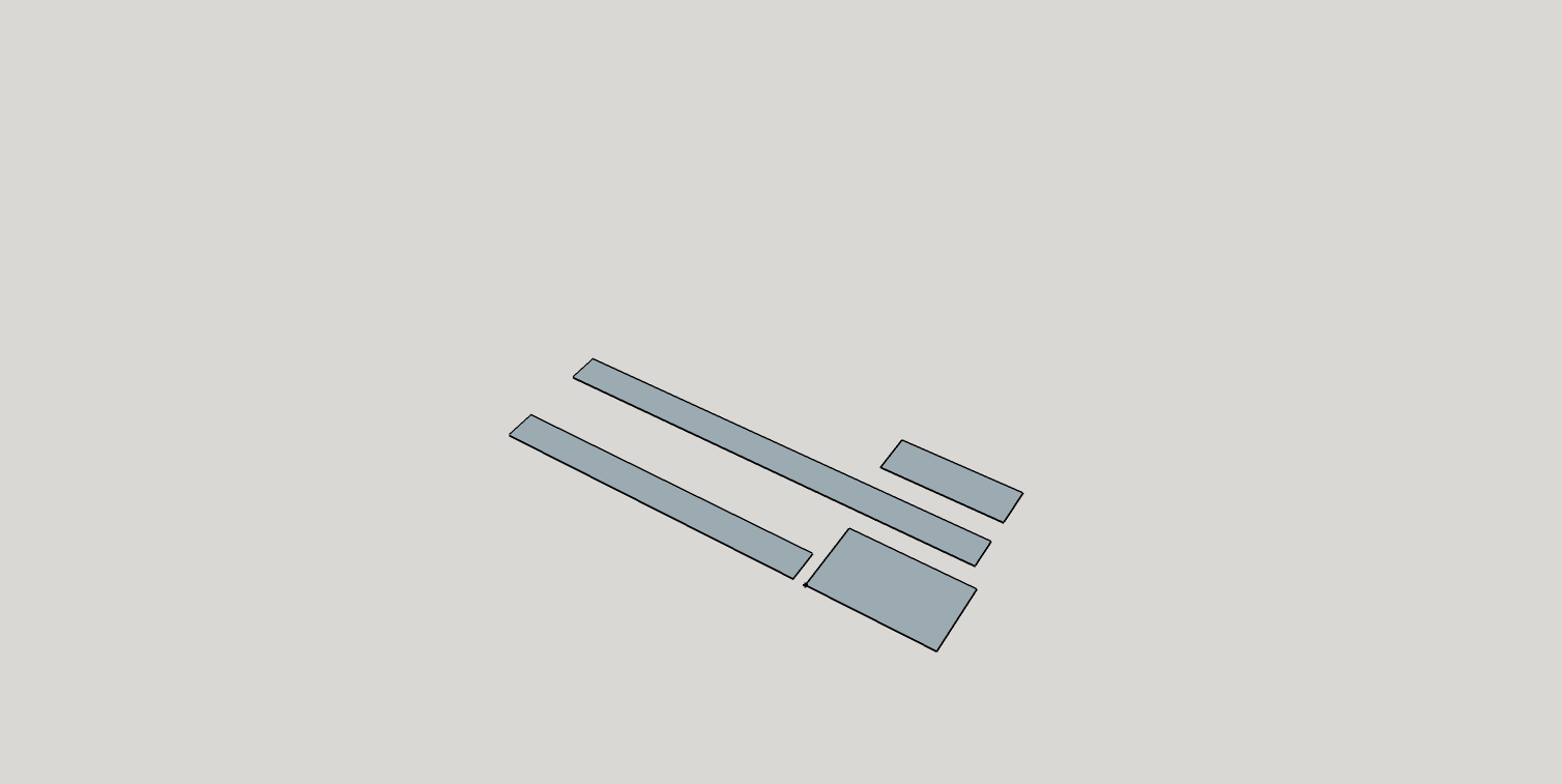

I would recommend the first cut to yield a piece 16x90 and that the second cut (rip) give you a final piece that is 7x60.berry wrote:In my woodworking I often get to this point and find myself not sure of how I should proceed.
I have a piece of pw left over from another project 16 x 96 and I need to cut a piece 9 x 69 for my next project. Is it better to rip the stock first and then have a pieces 7 x 96 and 26 x 9 OR should I make the cross cut first and have pieces 7 x 70 and 26 x 16 as the off-cuts? And if you answer this take a second to explain your thought process. TIA
I prefer getting down to the smallest size possible as quickly as possible. Small pieces are easier to manage while cross cutting than are larger pieces.
Actually, I would cut them slightly oversize 7 1/4x 60 1/4 so that I could work the edges down to required dimension.
Your cut offs are going to be of similar dimension either way.
Which cut off is going to be most useful "for you".
