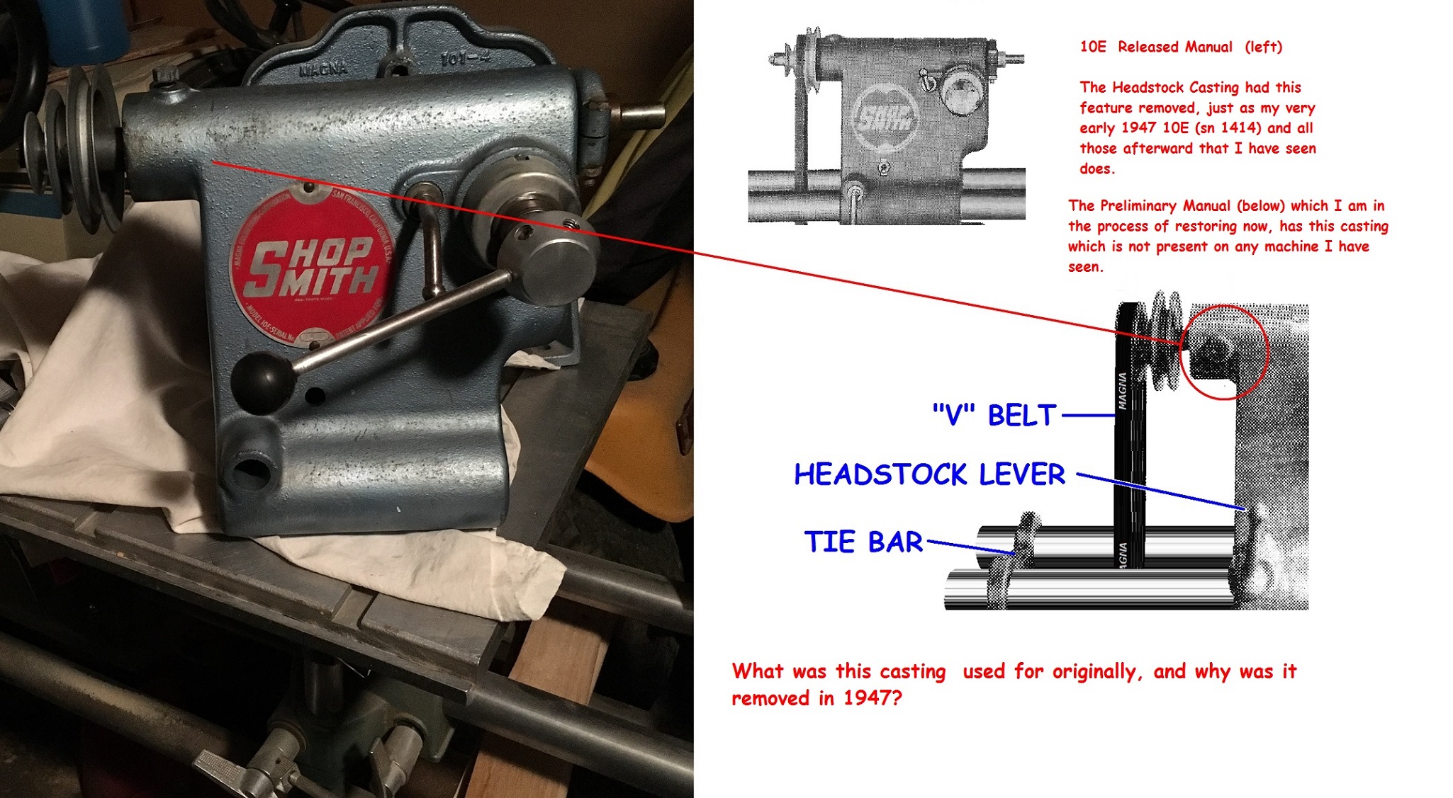

I am working to keep a promise I made to John Burger to restore and update the Preliminary MAGNA Shopsmith Manual.
I have come across a question I cannot find the answer to. In the attached photo, I have my 10E that I originally acquired through Dave H. (CO) in Colorado SN 1414.
Skip has long held that MAGNA sold approximately 4,000 units in 1947, the original first year of production which took off with Montgomery Ward offering it nationally in their stores for Christmas 1947, which makes my unit one of the earliest ones ever made.
That said, even being one of the first ones made, it does not have a casting that appears on the Headstock in the Preliminary Manual I am redoing.
Equally, it does not appear in the subsequent 10E Manual that I restored previously.
I have attached a photo illustrating the casting variance. Now I am wondering; "Does anyone living know what it was for, or why it was removed?"
Everett
10E Headstock Early Casting Changes from Preliminary Manual.jpg (667.16 KiB) Viewed 3622 times

An oops on the original drawings, an oops on the person that made the original mold? Who knows.
My guess is that it is the same as the casting/bolt hole on the top of the production castings to hold the belt cover. Maybe the original belt cover designer thought the attach point would be more convenient on the front of the machine. Then changes were made before production. We will never know.

Even though I have 3 ERs, I dont eat and sleep with them like some here. I may take a guess, it may have been for the jig saw???

I have become suspicious that that nubbin is for the setscrew that retains the bearing spacer on the drive sleeve. Later ones have a single set screw on the opposite side without that projection. I wonder if the ones with the projection had a twin on the opposite side.

I have #6834 and it doesn't have the casting nub either. I'm just assuming the originals had it with the assumption they would need two drive sleeve spacer retaining screws and realized one was sufficient enough???
Re: A question for you Other early vintage 10E Owners
Well I dug the 10E headstock out and it has that nubbin on the back side only.
So I think we can conclude that the 'originals' had a set screw on both sides.
I also think that that double nubbin presented a sand casting problem.
