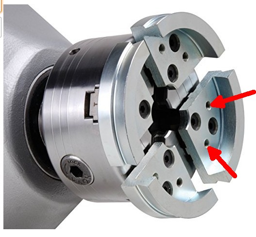

Nova jaws, what are these holes for?
I've just ordered a larger set of jaws for my Nova chucks and noticed these holes. Just wondering what they are for, none of my other jaws have them but then they are all smaller......... They should be here on Monday so maybe the paper work will tell me but if you just happen to already know? Please don't waste your own time looking it up, just if you know and post a line of two that would be great.

reible wrote:I've just ordered a larger set of jaws for my Nova chucks and noticed these holes. Just wondering what they are for, none of my other jaws have them but then they are all smaller......... They should be here on Monday so maybe the paper work will tell me but if you just happen to already know? Please don't waste your own time looking it up, just if you know and post a line of two that would be great.
On line manual says they are for mounting optional wooden jaws. see page 31

reible wrote:That sounds interesing!
Not sure what the problem is but the link is not working for me.... sorry.
Strange it works for me but could be because I already have it downloaded.
Try this one. https://teknatool.freshdesk.com/support ... aw-manual-
