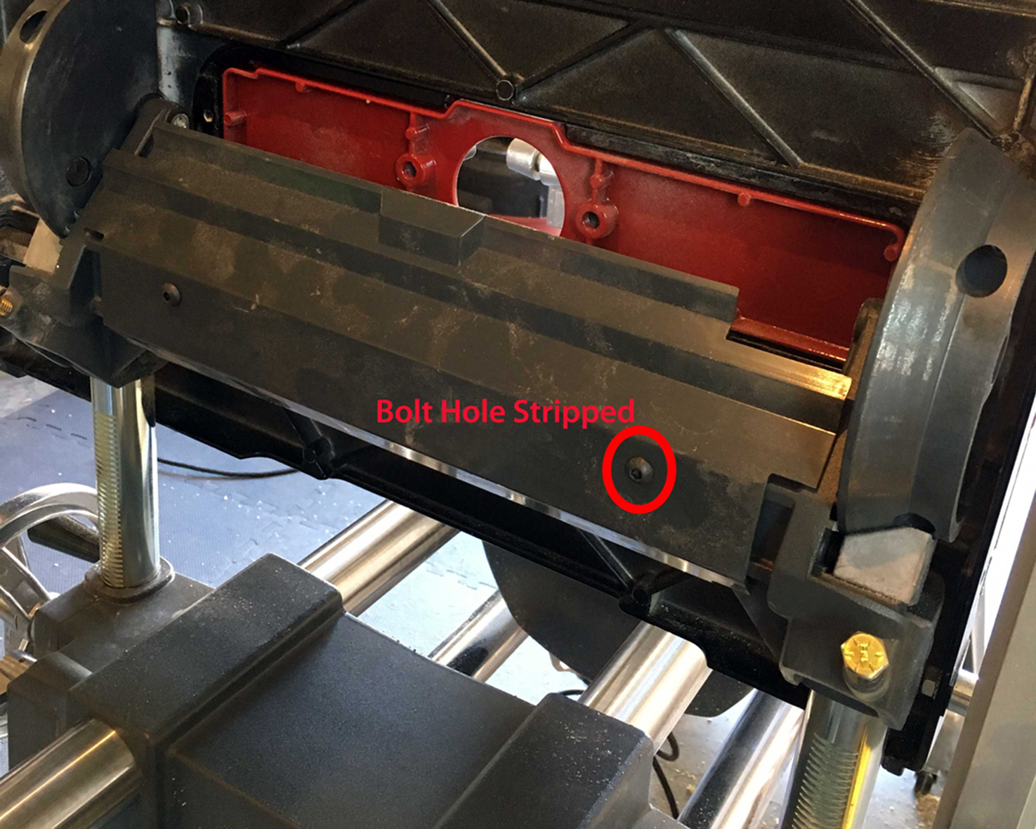

Has this happened to anyone else? I have a Mark 7 that I just bought brand-new in November - less than 4 months ago. I have primarily used the table saw, only moving it into vertical position for the drill press and router a couple of times. Today I switched it from table saw to shaper and had to take off the plastic tie bar guard under the work table - I honestly think it's only the third time I've done this - and when I went to put it back on after using the shaper, one of the bolt holes was stripped. It won't even hold the bolt. I didn't torque it down or anything - I always just use the long allen wrench that comes with the Shopsmith, and you really can't put much torque on that. I'm going to call Shopsmith about it, of course, but I was wondering if this is a common problem. Did Shopsmith go too cheap on their metal castings so that the holes strip out easily?

- Bolt hole completely stripped
- Tie Bar Guard Bolt-compressed image.jpg (923.85 KiB) Viewed 5580 times

Is it the bolt that is stripped or the casting? Eitherway, not a terribly difficult fix. If it is the casting that is stripped, a temporary fixcould be a wooden match stick jamed intomthe hole...

A closeup picture of the hole would be helpful.
I am not aware of this being a common or recent problem.

If under warrantee call SS. If not you can drill it out a little larger and insert a helical coil that will bring the hole back to proper size and thread. Or you could log in to McMaster Carr and order 4 or 5 slightly larger button screws and drill both of the holes and tap them the new size. badabing badaboom. I have never had a stripped screw on my Mark V upgraded to PowerPro and bought it new in 1984.

I don't know how to do that without getting the cap screw removed. Besides, stripped threads all look alike to me.JPG wrote:A closeup picture of the hole would be helpful.![]()

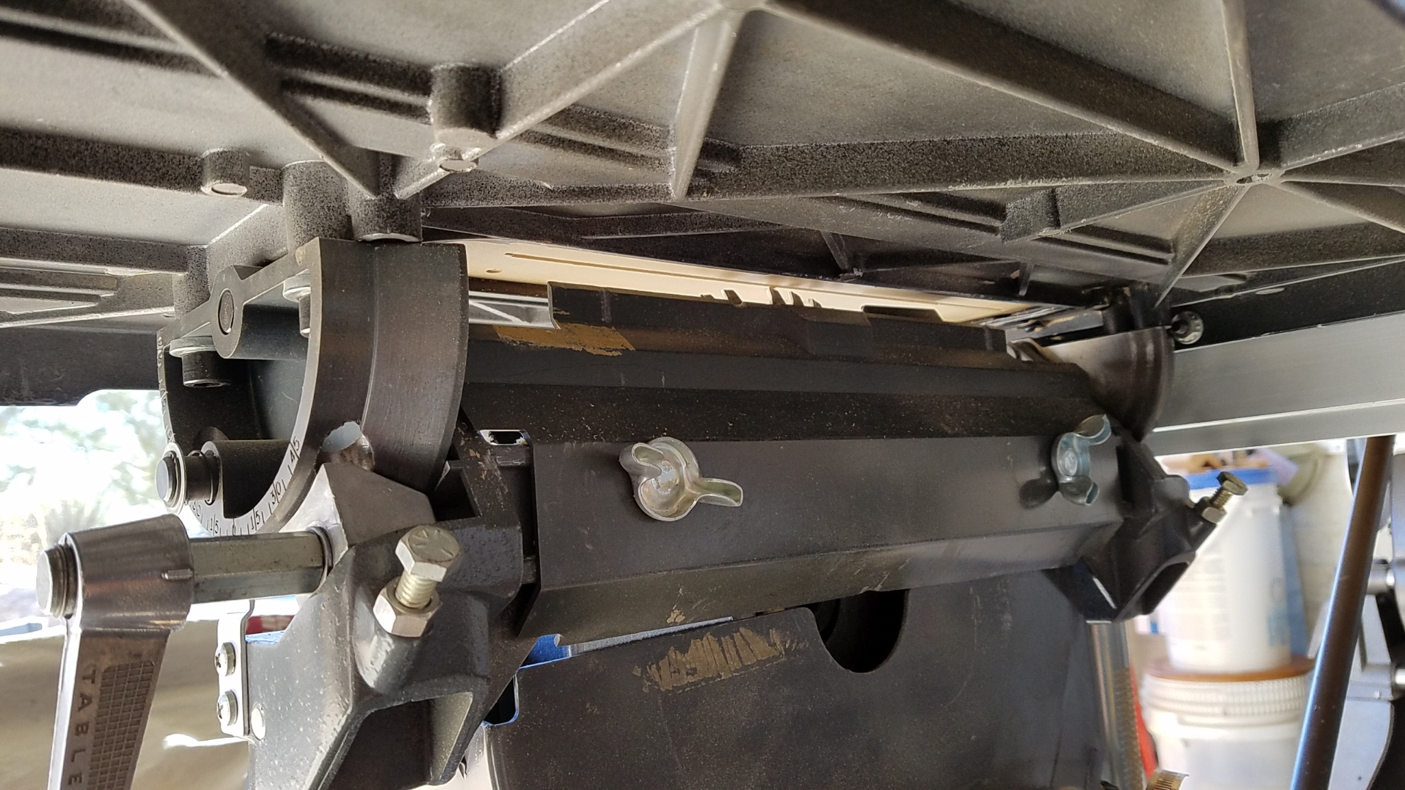

I'd contact Shopsmith before I did anything else. They might send you a new Table and Tie Bar Assembly. At any rate, GET THE SCREW OUT, then tap or "drill and retap" the hole with new threads. I am betting on the casting being cross threaded. An easy thing to do if parts like these are attached with power tools.
Side Comment: I use wing nuts here. Eliminates the need for a tool if I want to remove the dust cover.
One good thing. You can still use the machine for any of its functions. Dust collection will be poor but that is the only down side.

Threads can get cross threaded(multiple lead), stripped out or just jammed. The corrective action varies with each.
Regardless SS CS needs address this before taking further action(other than removing the screw..).

Thanks Dusty, JPG and all. I like the idea of the wing nuts - I'll probably do that once I get the current issue resolved with Shopsmith. I know it wouldn't be a big deal to bore out the holes and tap them for a bigger bolt, but it's really frustrating to have this happen with a new machine.

Coming out of Shopsmith, I suspect it is a very seldom occurrence. However, it may being happening to others. I find those screws rather difficult to install and have gotten them started only to find that I am cross threading. So far, I have been forced to drill out asnd replace only the one machine pictured and on that one only one hole was damaged. I did both for obvious reasons.kkoyle wrote:Thanks Dusty, JPG and all. I like the idea of the wing nuts - I'll probably do that once I get the current issue resolved with Shopsmith. I know it wouldn't be a big deal to bore out the holes and tap them for a bigger bolt, but it's really frustrating to have this happen with a new machine.
