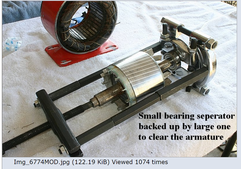

I see this will work as a puller. Will this work as a press? I just thought once I get the bearings off how do I get them back on? Sorry haven't started the tear down that is about two weeks away. So questions come at random times.

sjroark wrote:I see this will work as a puller. Will this work as a press? I just thought once I get the bearings off how do I get them back on? Sorry haven't started the tear down that is about two weeks away. So questions come at random times.
Yes it will. :)

Check out MickyD's post in 2009 he posted in his restoration project.
http://www.shopsmith.com/ss_forum/viewt ... 556#p43556
Everett
Puller and Press from MIckyD's thread post.png (1.6 MiB) Viewed 4057 times
