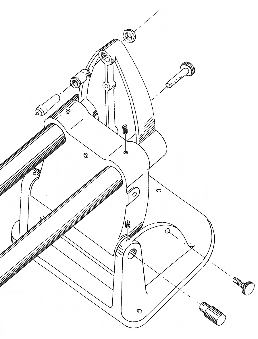

I have been restoring a 10E my uncle gave me, I have not been able to find any info on a tailstock, I am not sure if the 10E has a floating center like the 10Er? Here is what I am working with. Any opinions would help.
Re: Question on 10E
The 10E did NOT have an adjustable tailstock. The #2MT is machined into the cast iron tailstock.
FWIW a 10ER tailstock will 'work' with the 10E and it HAS an adjustable socket.

Here is an illustration of the 10ER version
Everett
10ER Tailstock from 10ER Manual I restored last year..png (430.07 KiB) Viewed 1556 times
