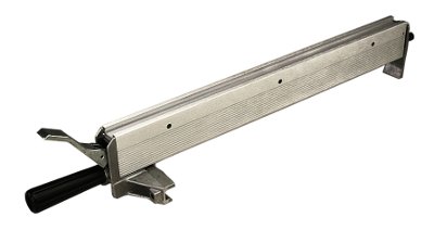

Chris,
You want the 510 Fence on your 500 Table and couldn't spring for the 510 upgrade. Shopsmith thought of that some years ago.
http://www.shopsmith.com/ownersite/cata ... pgrade.htm
Mark V Model 500 Rip Fence Upgrade with T-Slots.jpg (13.83 KiB) Viewed 14062 times
Rip Fence for the MKV Model 500 555646.pdf
Manual for new 500 Fence
(427.35 KiB) Downloaded 1182 times

Dansmith wrote:I was afraid that I would have to get the carriage as well.
I still have the 500 table and fence system, and have never really considered upgrading to the 510 or 520 (though I have toyed with the idea of just the 500 fence upgrade that Everett pointed out.) But as I learn more about the differences between the different models, the carriage is just one of many items that are incompatable and would need to replaced. Other items include upper and lower saw guards. While not 100% necesssary, the 1-1/4" and 5/8" saw arbors, and sanding disk arbors are also different and for best functionality also should be replaced. You might want to study the 510 Upgrade listing from Shopsmith to see what is included and what other items might need to be replaced.
http://www.shopsmith.com/ownersite/catalog/500to510.htm

everettdavis wrote:
ChrisNeilan wrote:I'm on the fence on this- I just had to say it and apologize for the pun! I'm not putting the 510 table down at all, only that I prefer the 520 fence. If I had to do it again (upgrade my 500), I would consider the 510, especially since you can find them readily on Ebay, and quite affordably as well. As it happens, I can swap my 520 fence between the two Shopsmiths and do not need a second fence.
Chris,
Mark V Model 500 Rip Fence Upgrade with T-Slots.jpg Rip Fence for the MKV Model 500 555646.pdf
Never indicated that I wanted the 510 fence on my 500 table. I upgraded to a 520. I prefer the 520 table and fence. For me it was the way to go for the projects I am involved with. I picked up the carriage and table for about $100 on eBay. I already had a Mark 7 so I could use the guards, extention tables and fence that I already have.
