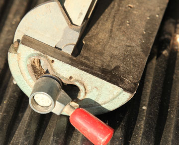

You may have already figured this out but I thought I'd add my 2 cents: I too have a Sigma planer (I also have a Sigma band-saw). The planer adjustment is a three-function bolt/nut with red handle attached. First position adjusts one function, there is a neutral position in the middle, and the third position adjusts the other function (I have forgotten which functions but can go find out if necessary). I have tried to attach a photo for clarity.
Planer Adjustment
Planer Adjustment
