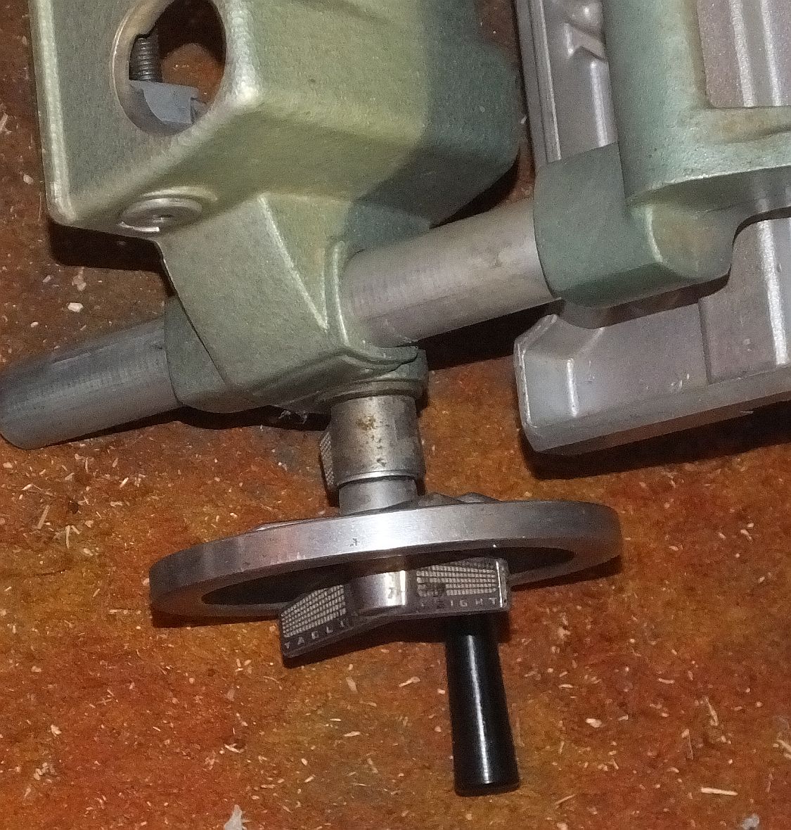

500 with height wheel mounted on backside

The back side of the table overhangs less than the front. Actually it clears the table substantually and the table travel is again limited only by the way tubes.
TABLE ELEVATION CRANK ON BACK SIDE.jpg (364.73 KiB) Viewed 4147 times
