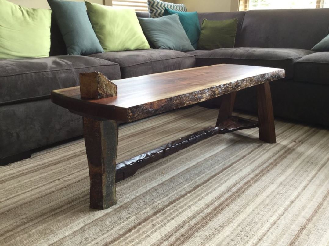

This is an interesting pic that I saved to my cool-woodworking-projects file a while back. Not sure, but I probably saw it on LumberJocks. It doesn't have a waterfall leg, but the "peg leg" is through-mortised, and made of stone.
Unique walnut coffee table.JPG (128.64 KiB) Viewed 12477 times
